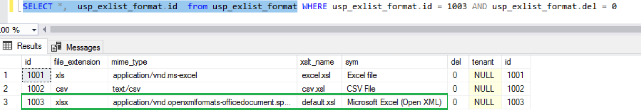

    Can you check the contents of the table usp_exlist_format in your database?
    Run the query as "SELECT *, usp_exlist_format.id from usp_exlist_format" and see if there is an entry with id 1003 to support xlsx format or not?
    If not we need to update this table.
    Necessary dat file is delivered as part of 17.3RU17 and ideally it should be executed as part of post installation steps.
    From the command prompt go to directory $NX_ROOT\data\ and execute the command as below to update the usp_exlist_format table.
    pdm_load -f r17_3_17_insert.dat
    Once pdm_load is successful, verify the issue.

    in our environment exlist_format is complete.
