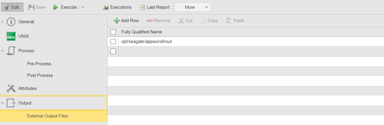

Is there anyway where I can define the Report path during Run time or is there a way where I can write a report to a certain directory. I tried the external output file but it didn't work for me.
