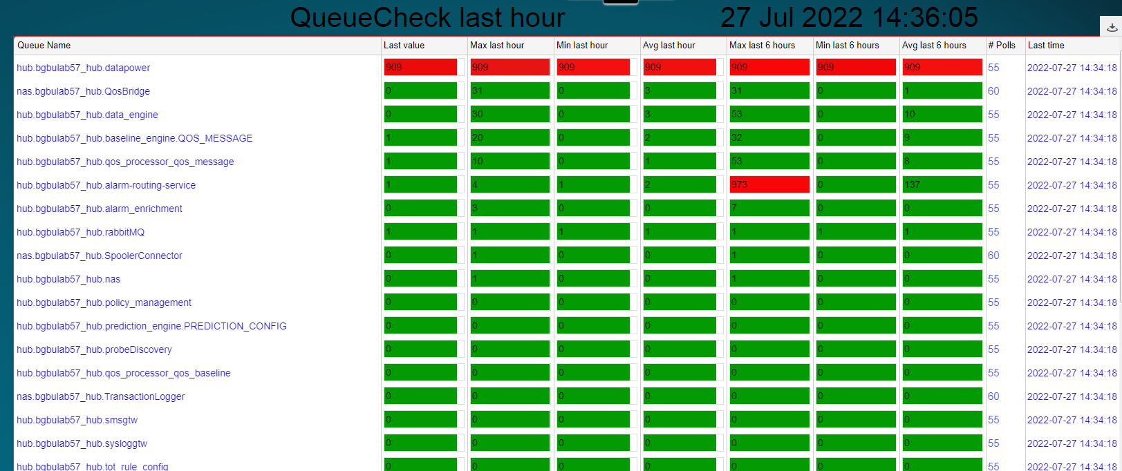

    Sample dashboard based on qos: qos_queuecheck_queued
    Sample dashboard based on qos: qos_queuecheck_diff: (this will show #alarm/qos each probe interval)
