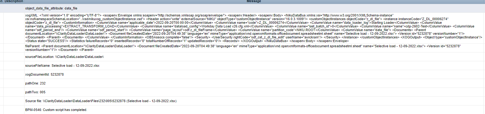

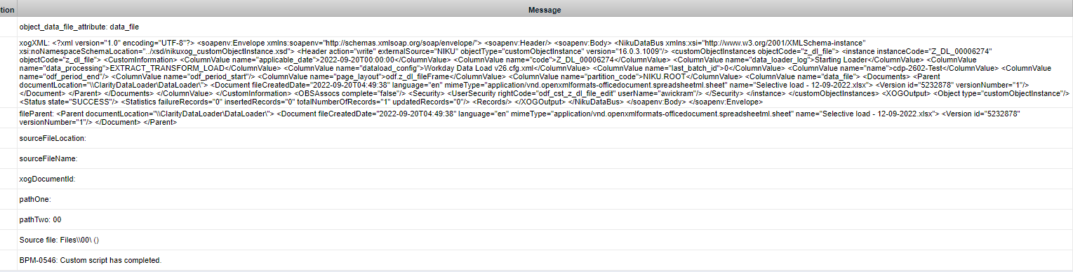

    The script is attached and the two different outcomes are shown in these two screenshots.
    In 15.9.1 all is OK, the variables extracted with the gel:set tag are fine:
    But in 16.0.3 they are no longer extracted:
    The fix is to remove the /text() from the tags. For example, change
    <gel:set asString="true" select="$fileParent/@documentLocation/text()" var="sourceFileLocation"/>
    to
    <gel:set asString="true" select="$fileParent/@documentLocation" var="sourceFileLocation"/>

    This is due to upgrade in 3rd party Jaxen Library and we did document the same and this change was done in 15.9.2
    Ref - https://knowledge.broadcom.com/external/article/217490
