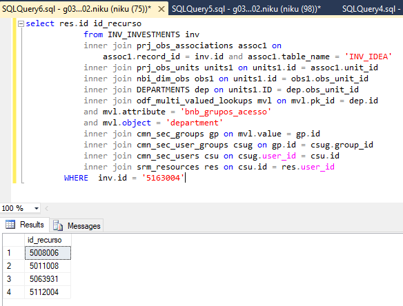

I'm a bit confused - it doesn't take a lot. When you executed the query above the ID inserted was 5163004, but in the error it says the ID is 5175001:
<column name="ID">5175001</column>
<column name="name">Demanda Teste HMG7</column>
<column name="UNIQUE_NAME">GAPRE001285</column>
Which suggests the query as executed in the script hasn't returned the data that you see when you executed it manually.

Where, as you can see, the values that have come back are not the same as the ones in your manually executed query, and they do indeed contain the value 1 (the admin user).
I'm guessing this is the problem and 1 is not a valid value for the lookup that controls the attribute.

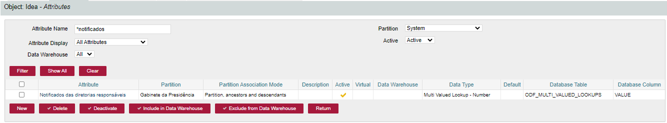

The custom field created is Data Type Multi Valued Lookup - Number linked to the Lookup Resource browse. And it is in this custom field that we try to save the result of that query, but the error I reported earlier occurs.

It looks like the attribute has its values controlled by a lookup. What are the valid values in it?
Also if you execute this query
select res.id id_recurso from INV_INVESTMENTS inv inner join prj_obs_associations assoc1 on assoc1.record_id = inv.id and assoc1.table_name = 'INV_IDEA' inner join prj_obs_units units1 on units1.id = assoc1.unit_id inner join nbi_dim_obs obs1 on units1.id = obs1.obs_unit_id inner join DEPARTMENTS dep on units1.ID = dep.obs_unit_id inner join odf_multi_valued_lookups mvl on mvl.pk_id = dep.id and mvl.attribute = 'bnb_grupos_acesso' and mvl.object = 'department' inner join cmn_sec_groups gp on mvl.value = gp.id inner join cmn_sec_user_groups csug on gp.id = csug.group_id inner join cmn_sec_users csu on csug.user_id = csu.id inner join srm_resources res on csu.id = res.user_id WHERE inv.id = ?
for the investment what comes back for id_recurso? It looks like it's returning 1 (the Clarity admin user) and perhaps that's not a valid value for the lookup.

<Exception><![CDATA[CMN-0009: Attribute 'Notificados das diretorias responsáveis' has invalid Lookup Value '1']]></Exception>
