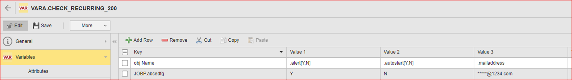

    Created 2 Vara objects -- one was a static of all the recurring workflows that ran.
    One listed all recurring workflows that were currently running.
    The Job ran every few minutes and it compared the two Vara objects and sent an email IF something wasn't running that should have been running.

    :SET &CONFIGVARA# = "VARA.CHECK_RECURRING_200"
    :SET &EH_VARA# = "VARA.SQLI.REPORTING_RECURRING_ACTIVE_NOW_200"
    ! :SET &MAILADDR# = ACTIVATE_UC_OBJECT(CLINT_CHKEVNT_TEST)
    :SET &HND#=PREP_PROCESS_VAR(&CONFIGVARA#)
    :PROCESS &HND#
    :  SET &NAME# = GET_PROCESS_LINE(&HND#, 1)
    :  SET &ALERT# = GET_PROCESS_LINE(&HND#, 2)
    :  SET &AUTOSTART# = GET_PROCESS_LINE(&HND#, 3)
    :  SET &MAILADDR# = GET_PROCESS_LINE(&HND#, 4)
