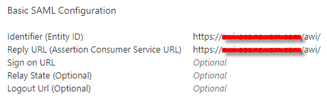

    No I'm one step furhter and I received a new error, but I think this is a problem in Azure
    Look like there is an configuration error in the Basic SAML Configuration
    I think this entry have not set to _INSERT_.

    Hi Jens,
    Replace the value with URL that points to your AWI instance or load balancer.
