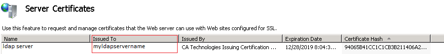

2. Ensure the Single Sign-On Configuration Tool-> LDAP Authentication-> Search Domain field is defined with the name that the certificate was Issued To:
     Single Sign-On Configuration Tool-> LDAP Authentication-> Search Domain field example:
     IIS Server Certificate example:
