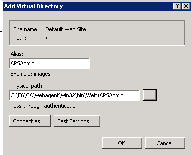

Define a virtual CGI directory for the directory that contains the APSAdmin CGI Program
      • Open IIS Manager ( type "inetmgr.exe" in the Run window and click enter)
      • Right Click on the Default Web Site and select Add Virtual Directory option. The virtual directory wizard opens.
                                  Specify as following :
                                  Alias : APSAdmin
                                  Physical path : <Web_Agent_Installation_Directory>\win32\bin\Web\APSAdmin
      • Click Ok

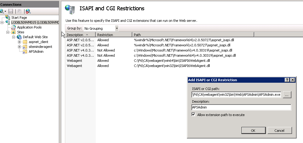

Add ISAPI and CGI Restrictions for APSAdmin CGI
      • Open IIS Manager and navigate to the server level.
      • Double Click on ISAPI and CGI Restrictions
      • From the Action menu click "Add" to add new restrictions
ISAPI or CGI path: <Web_Agent_Installation_Directory>\win32\bin\Web\APSAdmin\APSAdmin.exe
Description : APSAdmin
      • Click Ok

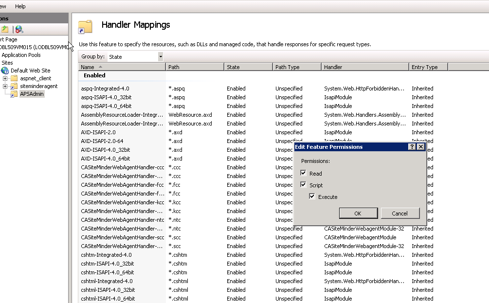

Edit Feature Permissions for the Handler Mappings Feature for APSAdmin Virtual Directory
      • Open IIS Manager and navigate to the APSAdmin virtual directory level.
      • In the Features View , double click Handler Mappings.
      • In the Actions pane, click Edit Feature Permissions.
      • In the Edit Feature Permissions dialog box, do the following:
Select Read
Select Scripts
Select Execute
      • Click Ok

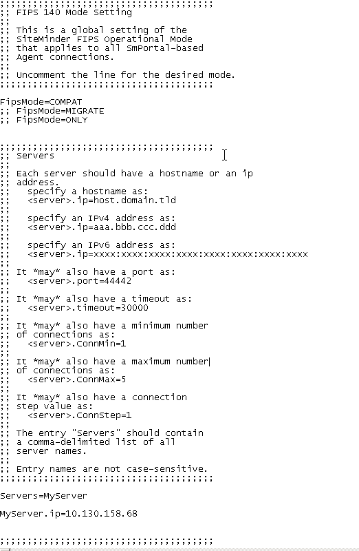

      • Edit the SmPortal.cfg file located at <Web_Agent_Installation_Directory>\win32\bin folder.
MyServer.ip = <Your Policy Server IP address>
By default, FPS is configured with a 4x agent by name "FPS" with shared secret "secret"
Change password is configured with a 4x agent by name "SMCPW"" with shared secret "secret"
By logging into the Administrative UI create the matching 4x agent as below:
      • The final SmPortal.cfg should look like following :

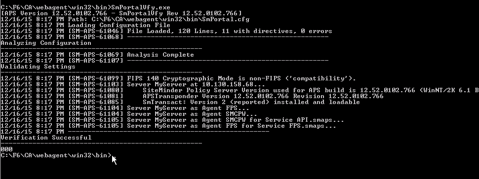

      • Validate SmPortal.cfg configuration using the SmPortalVfy.exe tool located at <Web_Agent_Installation_Directory>\win32\bin folder. It should state the verification as successful as below :

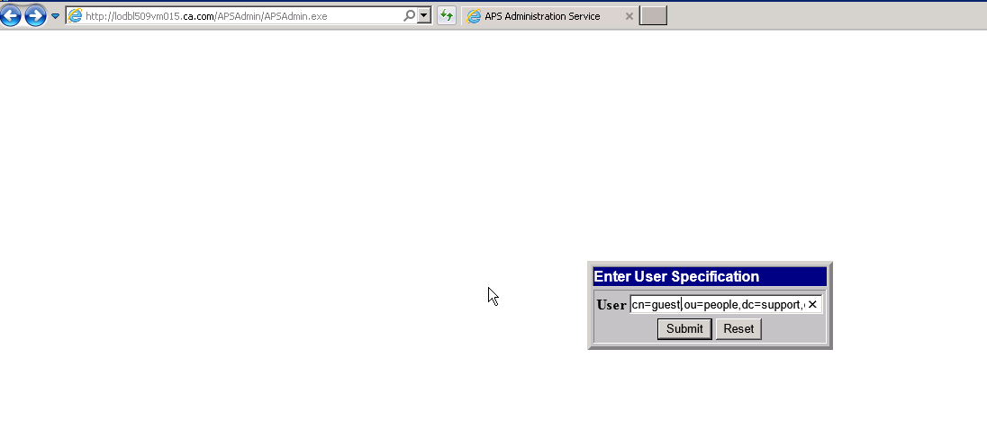

1. Access Help Desk Interface UI
    e.g. http://<server.domain.com>/APSAdmin/APSAdmin.exe
2. Provide valid user credential
3. Once the access to the interface is authorized, you will be prompted to enter the USER DN of the user which you want to manage.
    Enter the full user DN.
4. Next, screen should now show the User Information screen for the user
