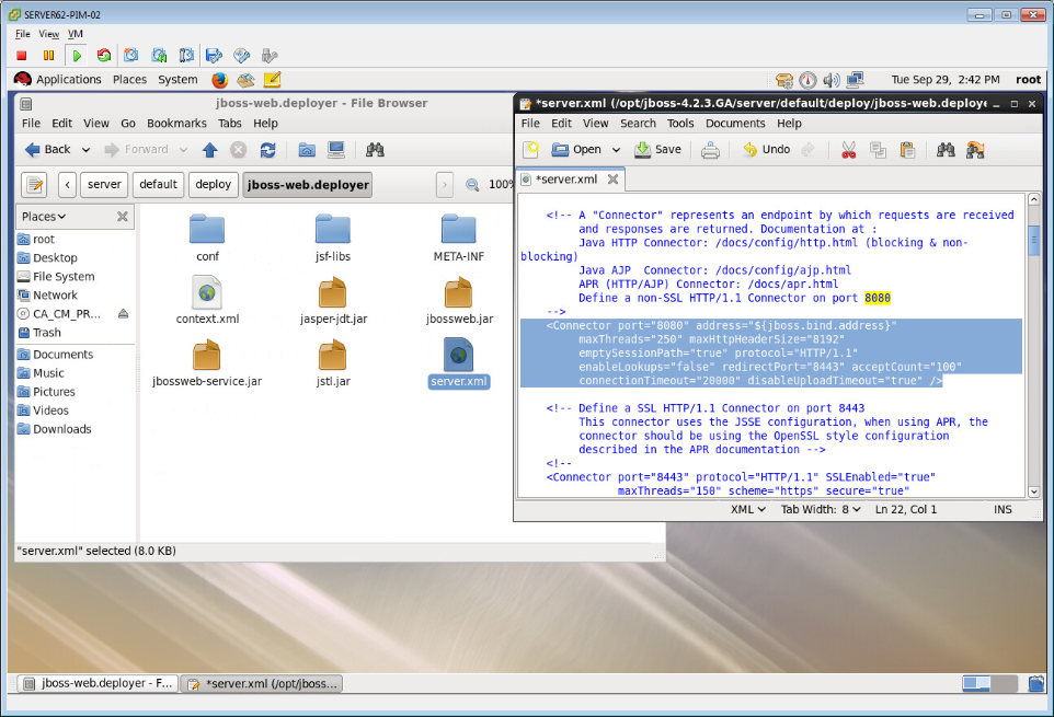

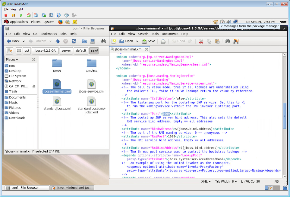

6. Configure JBOSS (to prevent port conflict with tomcat which will be installed later)
- /opt/jboss-4.2.3.GA/server/default/deploy/jboss-web.deployer/server.xml (Modify the port 8080 to 18080 and 8443 to 18443)
- /opt/jboss-4.2.3.GA/server/default/conf/jboss-minimal.xml
- /opt/jboss-4.2.3.GA/server/default/conf/jboss-service.xml
