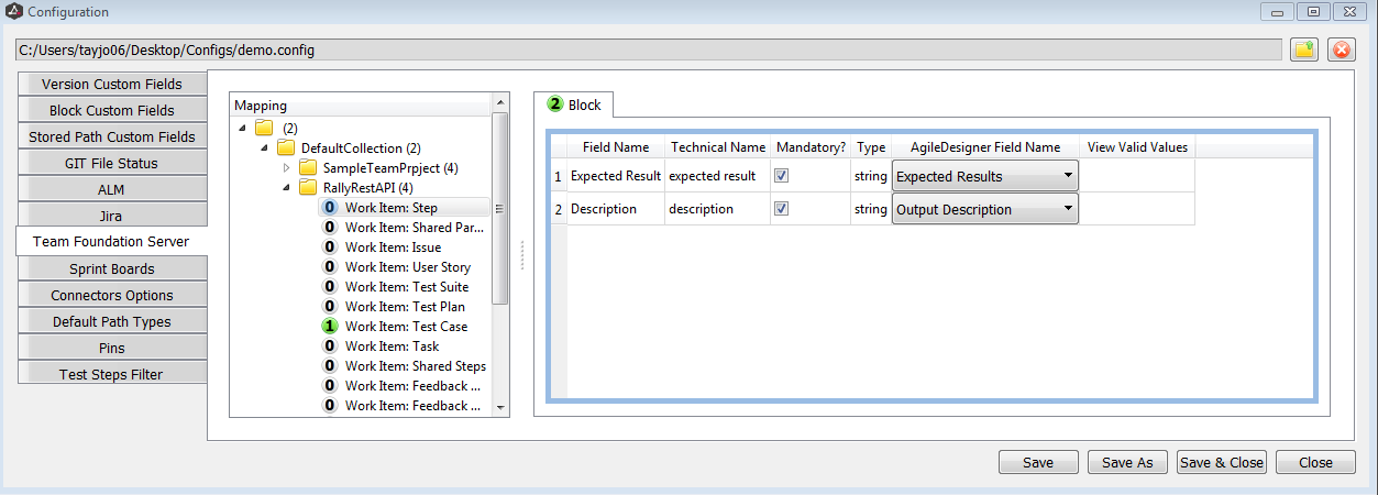

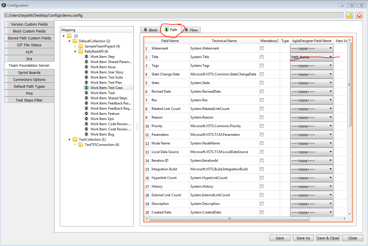

    4. Do these mappings help?
      • Below are some examples of some mappings you can use.
      • If this does not work in your environment, I would suggest waiting to use the TFS connector until it is available in a future GA release of ARD.
