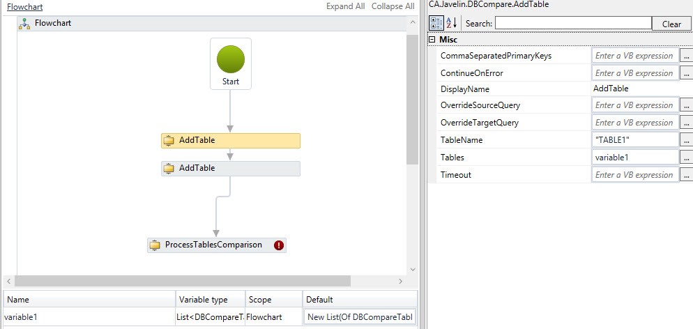

          AddTable activitity populates one table
          in Tables list
          so if user wants to compare 10 tables , the user adds 10 AddTable activities
          the list will then be used in the last activity processTablesComparison
          that last one creates a xml file to be fed to the dbcompare utility
