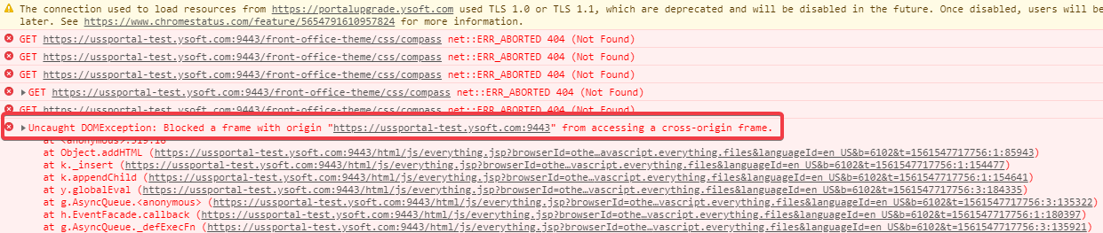

    Everything works fine until we tried to post a new question to the Communities. We get a CORS error
    I don't much understand Liferay and Tomcat, but I guess this can be resolved somehow... I've read some discussions and tried to change Tomcat settings, but it didn't help.

    It seems that the problem is the popup window which is used for creating new question. Some javascripts try to access the parent window which is in my case the Kentico portal on another URL and port. And this triggers the CORS error. I've tried to set the CORS filter in the USS portal Tomcat, but no success so far.
    Jakub

    Ok.   Yes,  "Ask a Question"    has nothing to do with catalog integration  ( i.e.  it doesn't involve any communication with service catalog )  then  .  It is just  pure USS ( liferay ) 's embedded communities feature .
    On my  17.1 USS env , i don't run into  the the problem you mentioned here with using  "Ask a Question"  .
    You may google that error to see if you can find any information about it in liferay communities .
