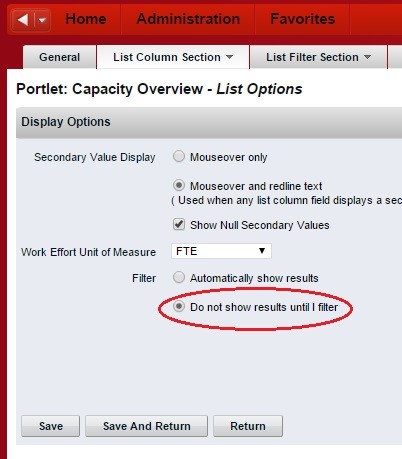

    1.     Set “Don’t show results until I filter” on portlets. This will improve initial load time.

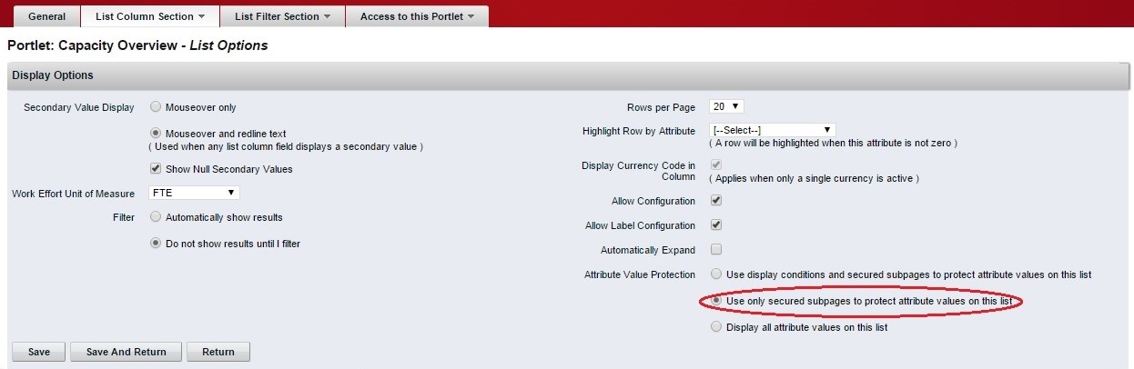

    3.     Set Attribute Value Protection (AVP) to faster setting of “Use only secured subpages to protect attribute values on this list” instead of “Use display conditions and secured subpages to protect attribute values on this list”.

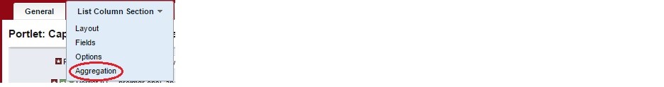

    4.     Remove unnecessary Aggregation rows. Each row causes additional calculations which can slow down the portlet. Be sure the row is removed, and not just hidden, as the row will still calculate if it’s configured and not marked “Show”.

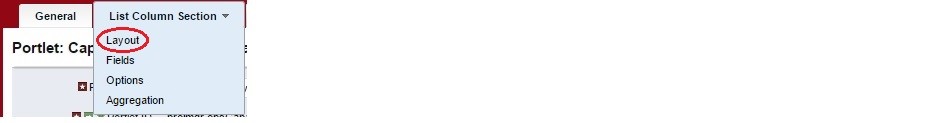

    5.     Limit the amount of columns configured in the portlet. It’s recommended to limit the amount of columns returned to 10-15.
