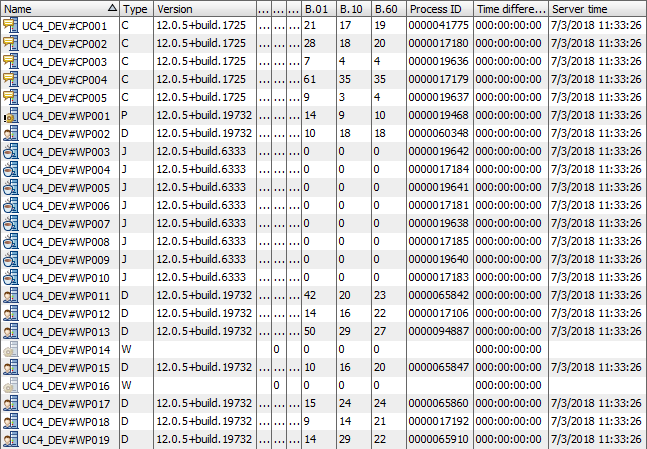

    We have recently encountered a problem that can cause Automation Engine server processes — specifically work processes — to hang. In this case, the WPs are not blocking DB sessions, and they are not consuming CPU time. They’re just doing nothing. They do not respond to requests to quit from the Service Manager. They must be killed with the KILL signal (-9) and restarted. We would like to find a way to identify such hung AE server processes programmatically, so that we can kill and restart them automatically.
    In the Java User Interface, we can identify hung processes by the fact that they appear grayed-out in the System Overview.

    I noticed that when WPs hang, they stop writing to their log files.
