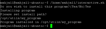

    In same cases deployment tasks include execution of scripts that required user inputs through interactive prompts during the script execution.
    The following example can assist you automate similar scenarios:
    Assuming I have deployment script name "interactive.sh" which include 2 interactive questions:
    1.Confirmation for program installation
    2.Program installation path
    Example for manual installation:

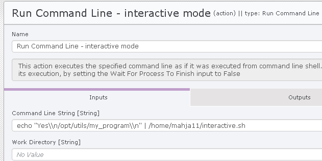

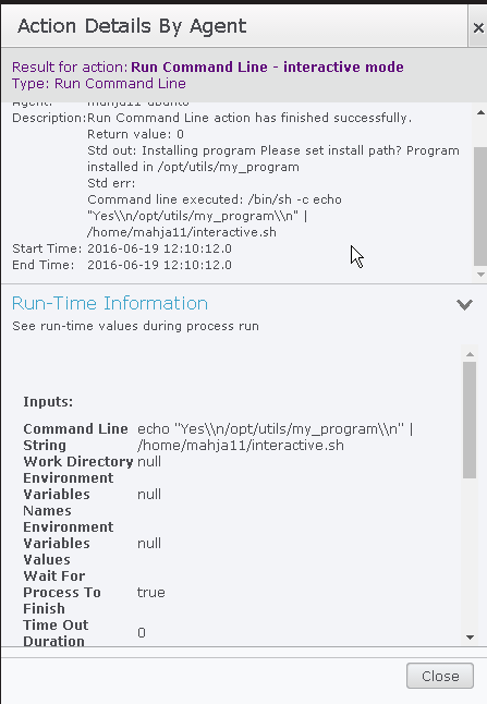

    In CA RA you can use run command line action and pass the user input using echo command (\\n use for new line sequence)

    That's neat, Jacky. I didn't know that. Another trick, which I'm not sure how reliable it is for use in production, might be to use/call an expect script.
    Cheers,
    Gregg
  • 3.  Re: Tech Tip:How to run interactive command line
    Posted Jun 20, 2016 10:10 AM
    Yes
    You can use expect command but its not part of the OS by default and required to write some scripts.
