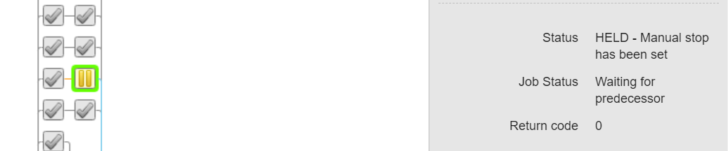

    I am new to Automic workload automation and need help from experts on knowing how get manually Help job details in filter option.
    Requirement is we want to Get list of all  manually held jobs from all workflows.

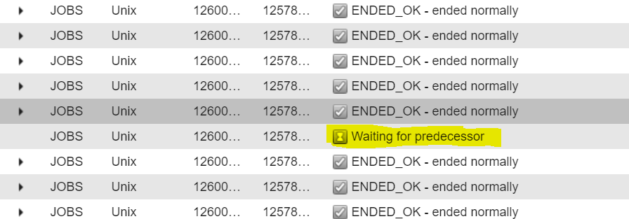

    in above scenario when we manually held a job while its predecessor job was executing its job status is still showing as waiting for predecessor but its status shows HELD-Manual stop has been set.
    and even in monitoring tab its status is shown as waiting for Predecessor
    Which is giving us no results as when we use filters for the same -
      Please share your views on the same .

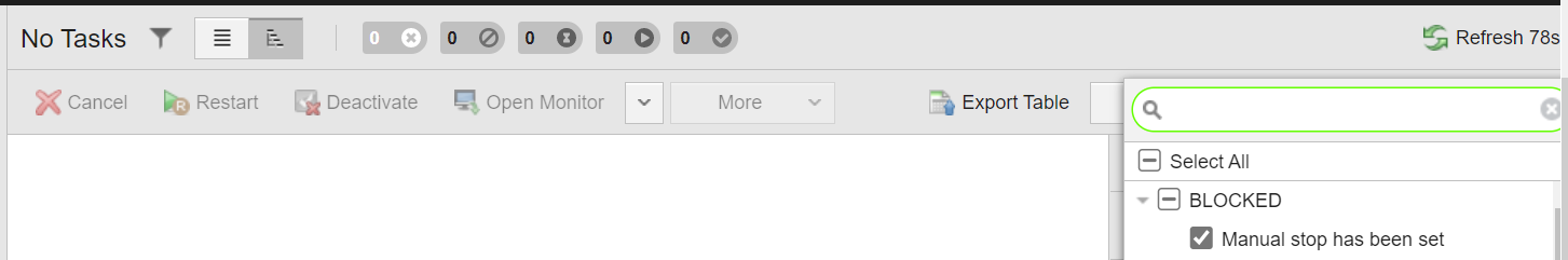

    @aalexander - Yes We tried that , issue is that we are not getting list of jobs after using filter as there are two status we are observing for JOBS one is STATUS and Other one is JOB STATUS, I guess filter only checks for JOB STATUS and not STATUS option.

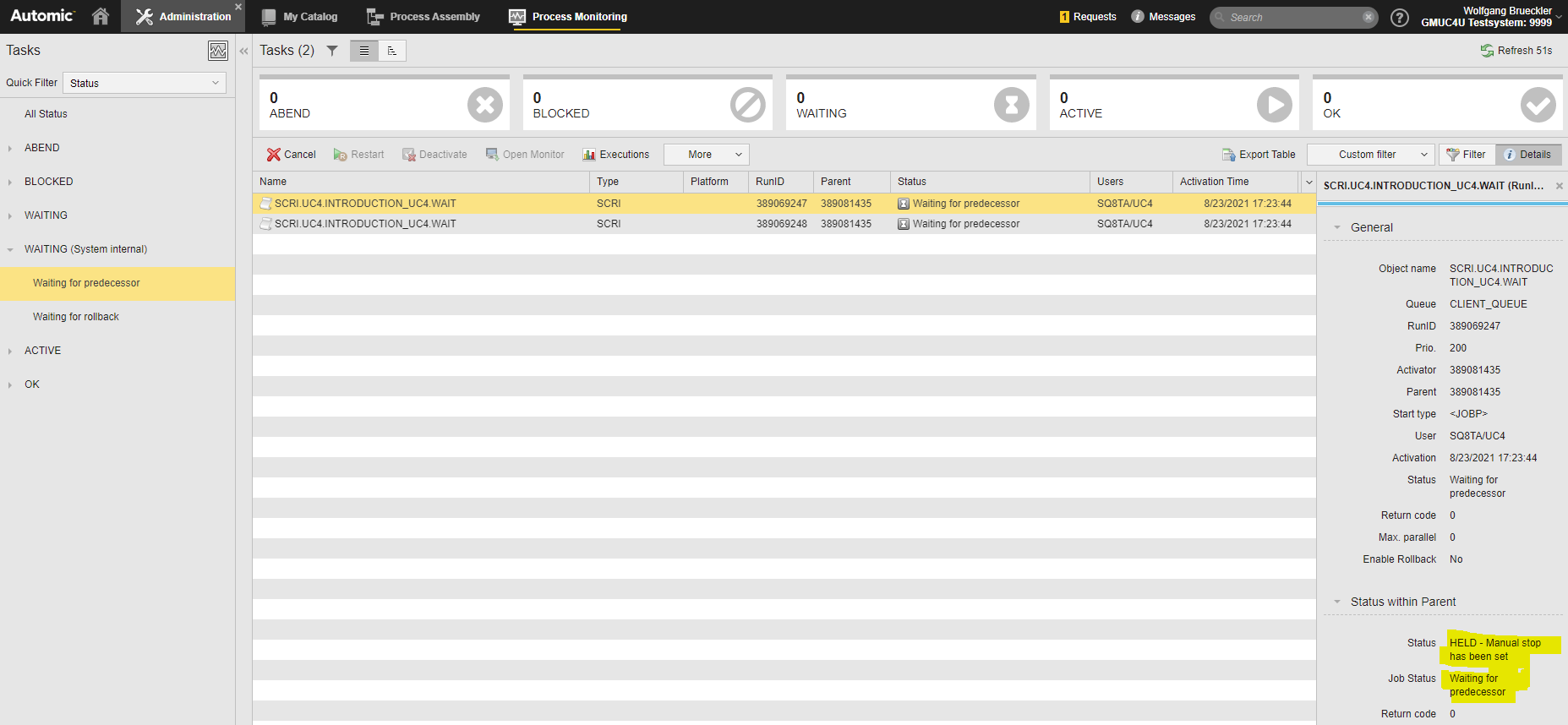

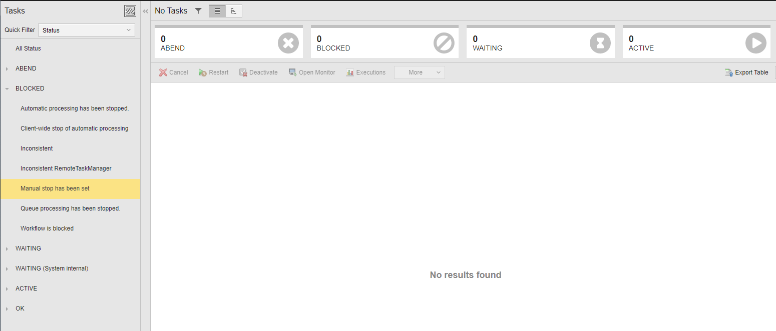

    Hi
    Seems like a bug in AWI (V12.3.4+HF1 reproducible)
    If you filer for manual "Stop"
    AWI returns nothing although there is one in status waiting for predecessor - manual stop has been set
    I would recommend opening a ticket @ AutomicSupport
    cheers, Wolfgang
