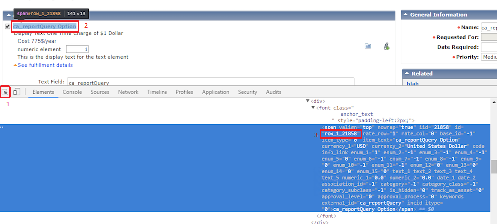

    At quick glance this does appear to be a bug and would suggest raising a case with Support for further review.
    As for a somewhat quick, albeit dirty workaround you could use two forms and leverage getDocumentById to get the first service option name similar to the following:
    1) Create a copy of the form, change the form _id and associate to the second service option
    2) Navigate to the offering from Home > Requests and grab the html id of the first service option name by inspecting the element using the browser console (shift+ctrl+i in Firefox/Chrome) similar to the following:
    3) Instead of using the JavaScript expression _.soe.item_text for the first service option name, create a JavaScript function in the Script dialog of the first form to invoke onLoad similar to the following:
    setOptionName:function(){
    var htmlSO=document.getElementById('row_1_21858').getAttribute('item_text');
    ca_fdSetTextFieldValue(ca_fd.formId,'txtf_11',htmlSO);
    Note: You will need to replace 'row_1_21858' and 'txtf_11' with the html id from step 2 and your text field _id, respectively.
    4) Update the onLoad attribute of the first form similar to 'ca_fd.js.setOptionName()'
    5) Remove the JavaScript expression $(_.soe.item_text) from your first form's text field

  • 26.  Re: How to export the selected service options to SDM?
    Posted Jul 14, 2017 11:07 AM
    Normally yes, the catalog hides the forms to allow faster access ...
    normally when you restart the service is enough.
    Make sure that your browser cache is also emptied.
    If you can not see changes to your form every time you make changes,
    you can apply the following doc in your DEV environment.
    (Https://www.ca.com/us/services-support/ca-support/ca-support-online/knowledge-base-articles.TEC1943332.html)
    You will be certain that no cache will be there.
    By default, the catalog keeps the forms cached for 24 hours.
  • 27.  Re: How to export the selected service options to SDM?
    Posted Jul 14, 2017 11:38 AM
    Great, now i get the right message: "2"
    Sorry for my lack of knowledge! Now that I get that message right, do I have to use my script to fill the text boxes in there?
  • 28.  Re: How to export the selected service options to SDM?
    Posted Jul 14, 2017 02:15 PM
    I tried with this code in the custom_form_lib.js:
    function SetItemText() {
    ca_fdSetTextFieldValue(ca_fd.formId,'txtTEST',_.soe.item_text);
    In Catalog works fine but in USS don't.
  • 29.  Re: How to export the selected service options to SDM?
    Posted Aug 08, 2017 11:52 AM
    Just an update. The variable doesn't work on USS so CA is working in a fix for it.
