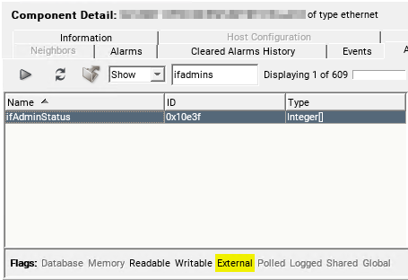

    Note that ifAdminStatus is an external attribute. Use this search with caution to avoid performance issues.
    You can find the ifAdminStatus (0x10e3f) attribute ID under the Port Gen_IF_Port model type:

    I´ve been searching only at root of ports folder thinking that should get all attributes of all subfolders like the GEN_IF_PORT, but understood now that I need to go  into all categories to search inside them .

    I would advise you not to create a search based on an external attribute. As Silvio was showing, Memory Attributes should be used first, then Database Attributes.
