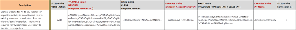

    The below diagram should help with the syntax.
    Action (ADD/DEL)     Variable (Base DN)       Class       Variable(Value)   IN (inclusion marker)      Variable (Base DN)     Variable(Value)    Semi-colon
