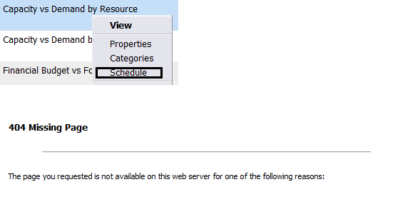

ie10 or ie11 will not work properly with infoview in the version of business objects that comes with CABI.
This is because the URL it parses when trying to view properties or schedule is incorrect.
