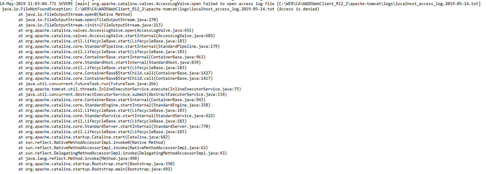

    In the logs I see next messages:
    I change the folder security to everyone with full access but, I have the same problem.

    The Tomcat is unable to access the log directory due to permission error.  This was likely due to install being via some other account and the account you are logged in as does not have permissions.  Try this:
    Go to "C:\WEB\CA\WADEWebclient_R12_2"
    Right Click then Properties then security Tab
    Provide required rights to currently logged in user.
