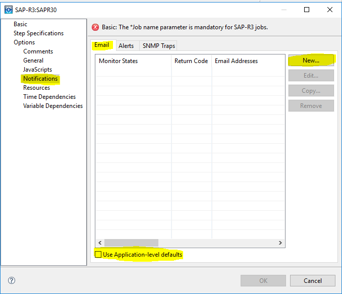

    Have you ever tried to create an email notification and send it to desired users?
    If not, you can follow the steps below:
    1- In the SAP Job properties window, under "Options", select "Notifications":
    2- In the "notifications" window, select "Email" tab, uncheck "use application-level defaults" option, then click on "new" button:
    3- In the "new email notification", configure all the notification conditions you need to be satisfied, as well the SAP users email addresses. Don't forget to check the "attach spool file option" :
