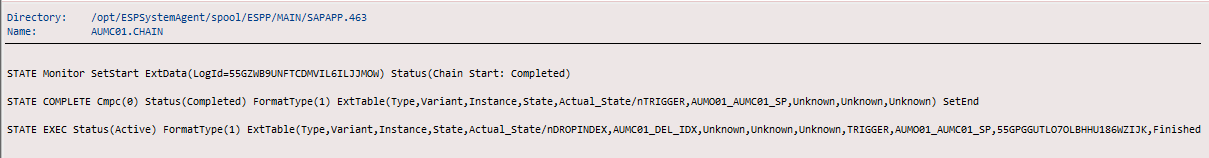

- BWPC_JOB runs a process chain and the ESP job completes prior to the process chain finishing. As you can see from the job spool, the COMPLETE message was sent before the EXEC status, which seems to be why it completed prematurely.
BWPC_JOB run a process chain and doesn't complete even though the process chain finishes. The log below shows that an exec message was sent back to the mainframe, but then ESP removed the monitor on the process chain causing it to not receive the complete message.
