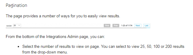

    There isn't a way to change the predefined page result sizes. You can see it here:
    Administer CA Agile Central integrations | CA Agile Central Help
    You probably can find a way to work with Drag and Drop ranking even with a result size larger than 200 if you will use filtering , then within less than 200 results because the fine tune your ranking.
    So, by using filtering, you may be able to put on one page results with otherwise are on different pages , so that you can then change the ranking.
    Please let us know if that helped.
