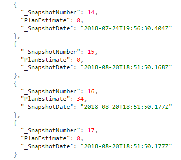

3. I did work a quick reproduction of this. I am finding that you are correct where you say that LBAPI indeed is showing '0' as the value of PlanEstimate for both unset, never-set and also those who have been explicitly set to '0'. I can't find it says '0.0' , I can only see it always reads '0'. See an excerpt below where snapshot 14 was unset, snapshot 15 was explicitly set to '0', snapshot 16 was then set to '34', then snapshot 17 was unset again. You can see '0' in all these snapshots (other than #16).
4. Personally, when I'm coming to think of it, I'm unsure it's wrong of LBAPI to tag unset PlanEstimate as '0'. I guess this field is mainly used for calculations and stats and mostly an unset value should suggest it be calculated as '0'. I believe it's for a reason.
