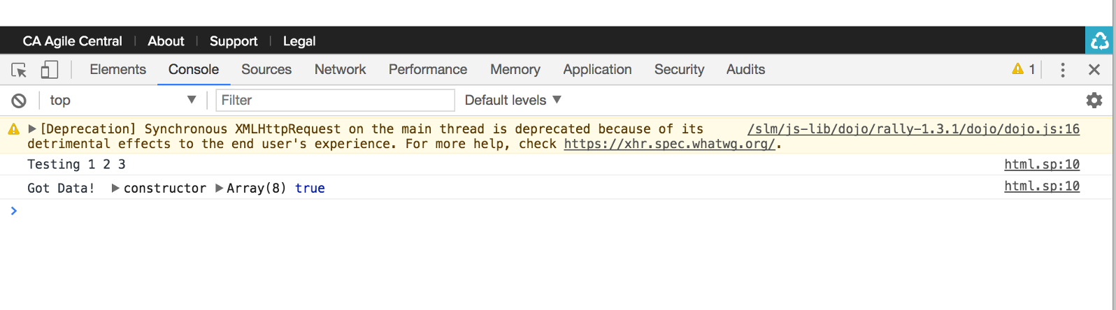

    You've already helped me!  What you said off-handedly has already helped me gain progress:
    Console shows that the app ran / is-running.
