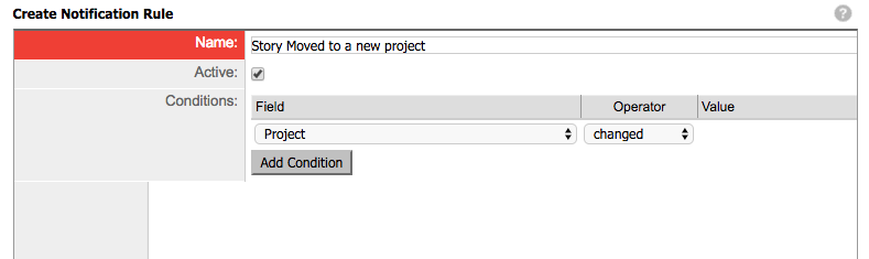

    Although there's not an easy way to get a "report" for this, you could setup a Notification Rule so that when it happens, you get a notification.
    In the email or dashboard notification (My Notifications app in the app catalog) it would say the before and after value for the Project.  It also says who made the change and when the change was made.
    Alternatively you could use our APIs to develop a custom report.
