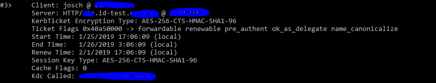

    How to resolve, why do i see this error, I have followed Document ID : KB000046427 and also followed step by step as documented by SungHoon and i have provided the SPN value of LB FQHN. Delegation is enabled. But i still get this error.
    Have created the keytabs with AES256, as per the below screenshot I could the tickets are in the same encryption type, but i still get this error.
    "Failed to create delegated GSSAPI token on behalf of HTTP/sts.id-test.****.***@***.***** for smps/n**-pps***-1.*****.**: Minor Status=-1765328370, Major Status=851968, Message=KDC has no support for encryption type"

    Found the issue.
    smpsprincipalName in the ACO has to be set properly. And resolved the issue.
