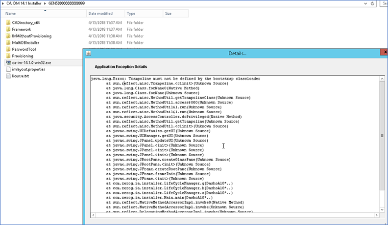

    Example:      IM Wizard Provisioning Installer - ca-im-14.1.0-win32.exe
    When executing the IM Provisioning Connector Server Wizard Installer, as the non-service ID (with local admin access), you may see this error message:   Java.lang.Error: Trampoline must not be defined by the bootstrap classloader

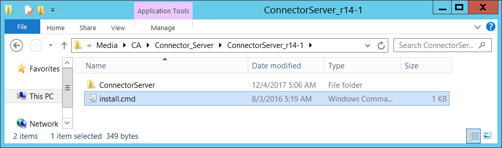

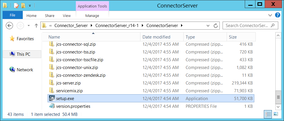

    Example 2:   Direct install via  Connector Server Installer   - setup.exe
       -   May be done also for the vApp Installation (via install.cmd)

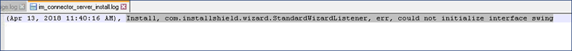

    - Error message will be a popup box (and error message in the log)  -  The Installer is unable to run in graphical mode mode.  Try running the installer with the -console or -silent flag.

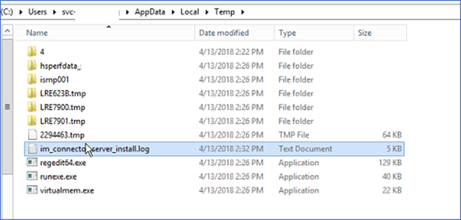

    - Error message #2, in the im_connector_server_install.log  (under %TEMP%  aka  c:\users\user\appdata\local\temp )
    com.installshield.wizard.StandardWizardListener, err, could not initialize interface swing

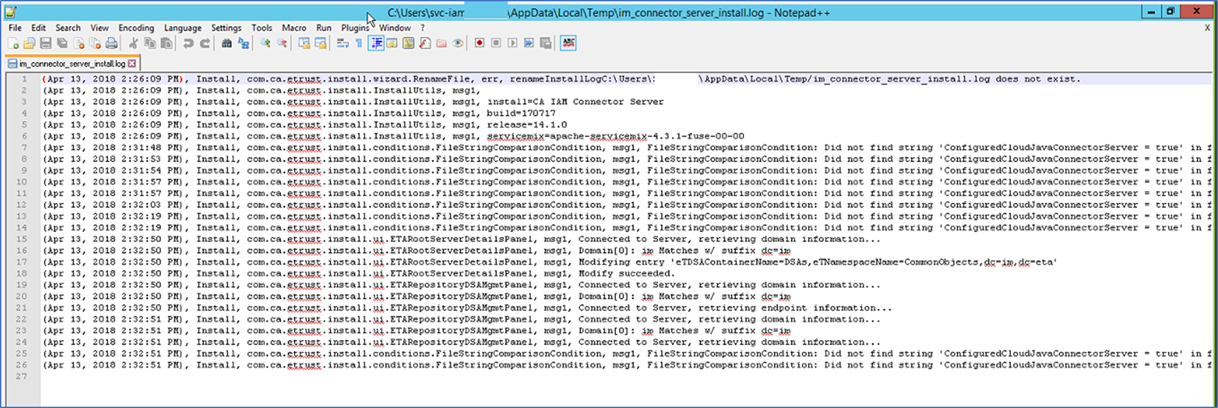

       Create an ADS domain service ID or local MS Windows service ID, and grant local administrative group access.   Then kick off either installer process.
    Note the success in the im_connector_server_install.log  as well.
