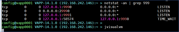

- After restarting the JVM, check with netstat -an | grep port_number that it is LISTEN on all NICs (0.0.0.0)
-Dcom.sun.management.jmxremote=true
-Dcom.sun.management.jmxremote.local.only=false
-Dcom.sun.management.jmxremote.authenticate=false
-Dcom.sun.management.jmxremote.ssl=false
-Dcom.sun.management.jmxremote.port=29990 [Pick a free port not being used by any application]
See example for the CA Identity Manager solution, with the provided custom JVM options for arguments.
For remote access, confirm the new JMX port (29990) is available on all NICs (0.0.0.0)

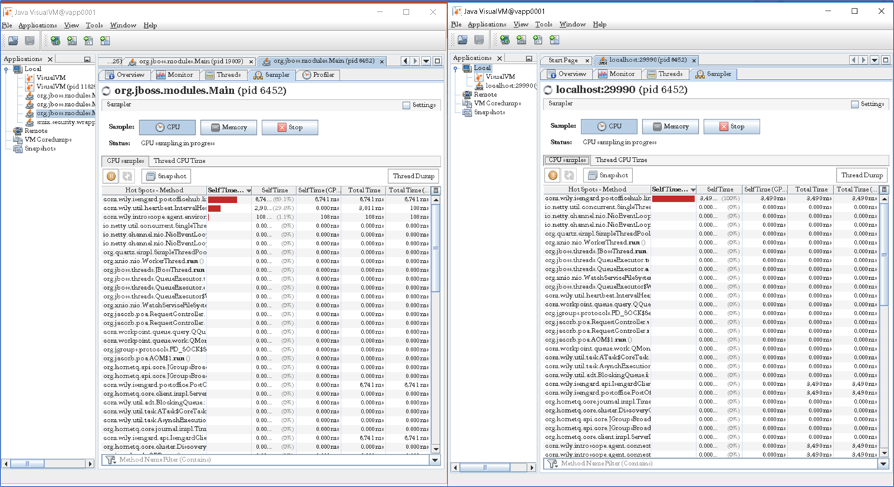

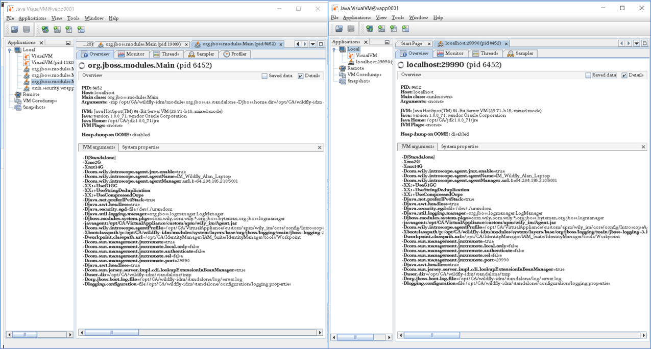

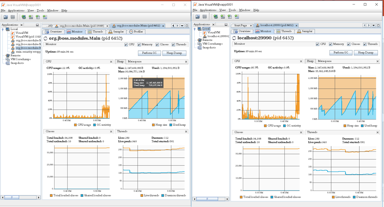

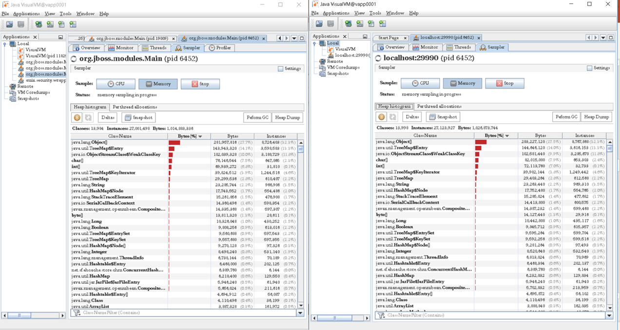

Example with Jvisualvm
- (Screen on left is run under user context locally; screen on right is accessed remotely by a different user context)

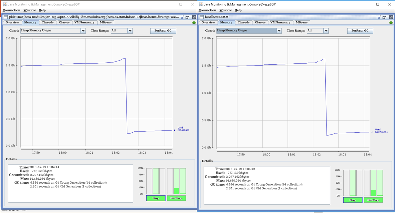

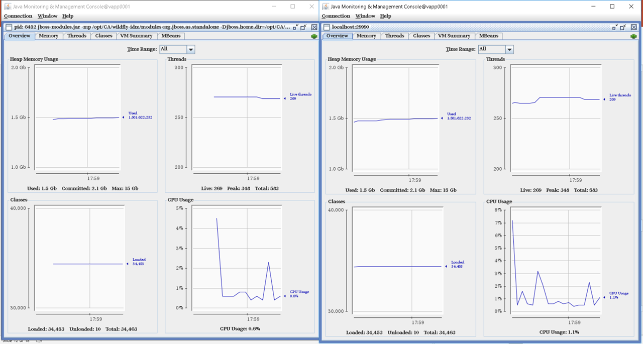

Example with Jconsole:
Need to add in Remote process to the port 29990.
