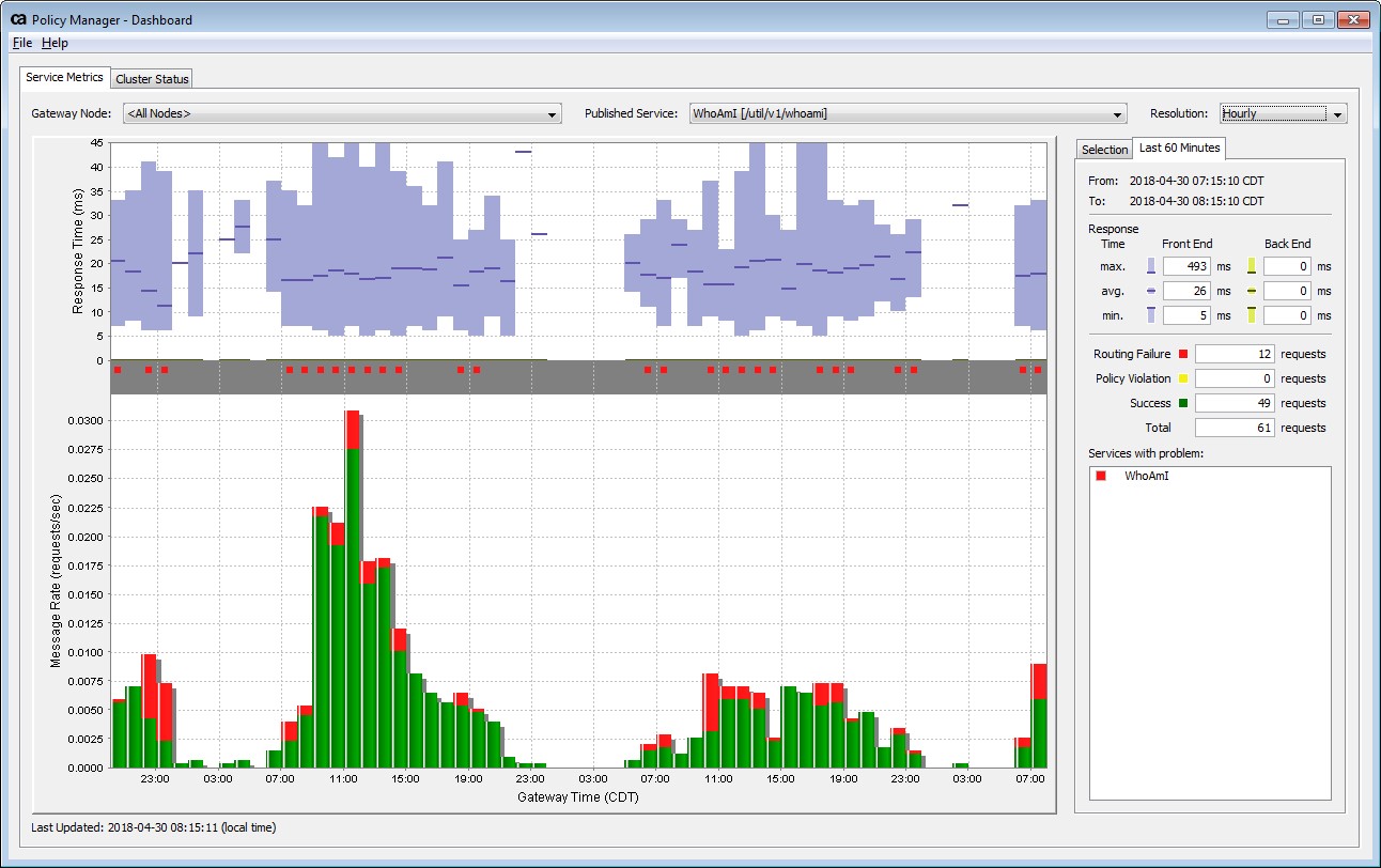

    we completed our production key store cleanup last saturday and it's successful. The reason for cleaning up our keystore is, we are having an integration in between CA API Gateway and CA SiteMinder policy server via Layer -7 agent.After the CA API Gateway upgraded from version 9.1 to 9.3 they are seeing the following errors more frequently.
    20180430 07:48:29.907
    WARNING
    10102
    CA Single Sign-On Authenticate Against CA Single Sign-On assertion: Unable to authenticate user using SSO Token:VSzzUIKgjyozGUoIabW0jtEEnSPVD6lTst77pRgJBjzJLryj6pCUAJhRiVugOp3WE6HNLRGjqYOhLtguanYwvbbSw8BMVusf8liF9JrqAfsIFs3/51CEDj5WRWg/S8a3OFG5hBfmHvUB/dJV6t2e1rYI2B52Cj7+i+GYqq9MH2KAjvVRujq+1+GurcdNhP27kXvqi8QltEN700kDNuhIj57lz/SghlOtXMknX5u1fLM9D+mGKmKdKD2Rt3ubTg2/LP4v7c0EV6kEXmXGNyd9Faw6LHTZyRKzJW/1iew4SGHpgReWi5eJFFSlwd970Gb5wyhMC3kCC/jZxSXFaqkk41sDAM76kKp3JzDyFV6CxOlBh2NpufSgnVS8oiKDcUDTIwMxKq0nZ3E2f3WWOKXbPSVnYd9s2rq6fEFA/xADzwoT4t39sPf/E4YqYf+aWy2Ar+kdQRsQ42FRe8uvX8tLoN00/5FckIdf7lb2YX53WJQBoM+55mmU6ziFrRqYFfTTbDBLXjRkrJ6I2b9R+W6uk+08fXSaxMuES3+1+0nSWxcw2pMu2G68+fG5IZJ/rhqycXReDmXjwO6xTvuU30qiOSq+2TZirankTICd3XfrlP0Pq5lDaFSP7ngDik/uNZw/oZQ+sVR3EfW9aDf/fxR7qff4GkyoirbAYE1+2pr7hpl5tUEFM7suNGdmYgxtBngNTf46yGzF4vrrq8Lp9X7kdB/hPqG63dIFKRWMSdHGXfmd4k7MPt+1f/GM4Ppztwr6cmhbe+Z3lh1iLa9cEIc/GKF3/8S3BZJut+aeX2DJkK7B2s4+sM74mAri6tdaMjyaoTlsCYV9sta89R0t0x9FxF/D16z3cKFshcX27rzGlSzlp4r9JKHdXfbeHSNauBFjEjpHrCtrVoh8LUONPIlKFsmXjW6x6vaCqa91+r7+yVwP3sVXoxPvdJaRWT2tNwnVJXqv77vIOAsa87v4vHXqPlFRzVTZ0sWNMmQWoVEbzTaxb294cFkvzN3ayGEYF9QokwU1ZwpKZQunn4k9rCsRekeakP0jPH1vYa61NczPskWyyAK6vMlZbwFPuTvfA68JliBPro5QZSaTIC0t4ewbbnqKaqRzJd1Bq8bvsJYvWrVZIN0EeC2CaO8sMJethS1OC/SnyfofvnZG71bEy+Yxdz8DRZ6Kn9UbH/zZ6mg+KmUkuV24dxLi39ZOZxMbAN6n8lIwI2C8DmxHSRdnh/SCBGbwipxfoD7G
    After i open a support ticket with CA, Support Engineer identified additional keys in our keystore and suggested to clean up the keystore to see if that resolves the issue. But even after the keystore clean up our API Gateway team still seeing these kind of errors. Not sure why it's happening. can you please advise?
    I am also including our API Gateway dashboard screenshot for reference.  Red indicates failure attempts and Green indicates success.
    Thank you,
    Naveen
