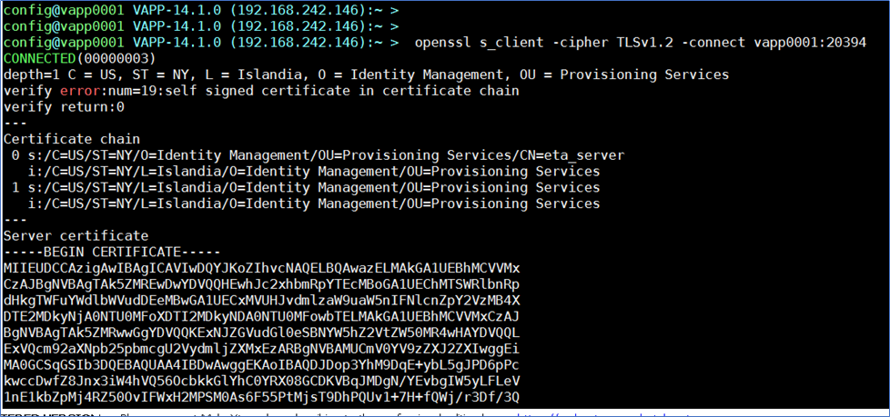

    Best example of success for latest release of TLSv1.2
    openssl s_client -cipher TLSv1.2 -connect vapp0001:20394

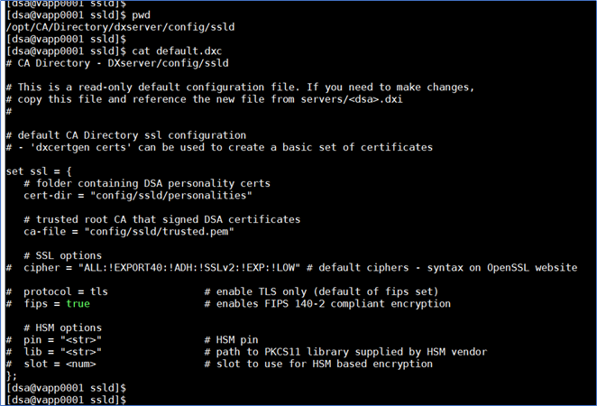

    To directly view the CA Directory cipher used (if changed from defaults), you may view these files:
    DXHOME/config/ssld/default.dxc
    DXHOME/config/ssld/impd.dxc

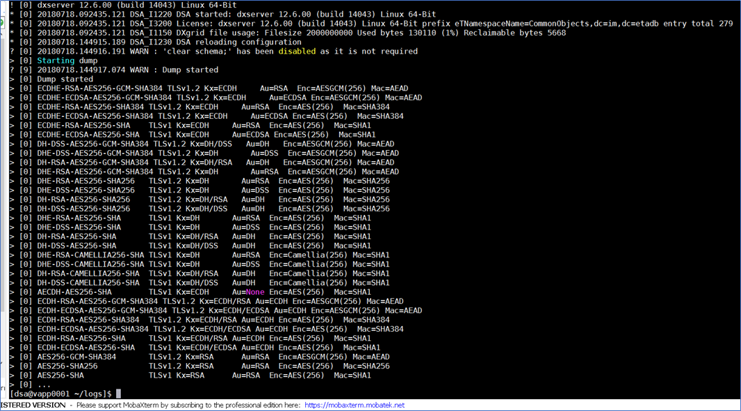

    To view all active CA Directory DSA cipher, open a DXconsole, and issue the command : get ciphers;
    - Or add this setting to CA Directory setting <dsa name>.dxc and issue a dxserver init <dsa name>
    - Then view the <dsa-name>-trace.logs.

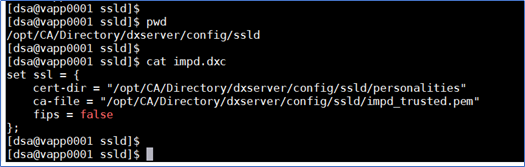

    Example to reduce ciphers to TLSv1.2 for CA Directory DSA upon startup:
    Edit the DXHOME/config/ssld/impd.dxc   (or default.dxc)
    - Update the set ssl = {  section as shown

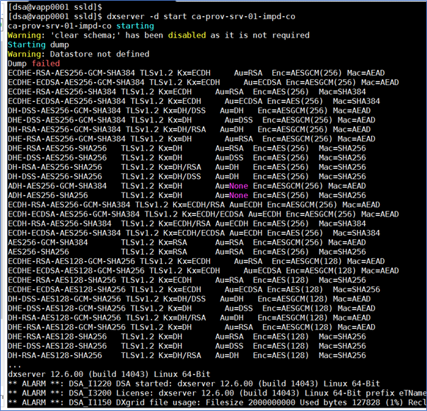

    Validate working with the -d switch for    dxserver -d start  <dsa_name>
    - should only see validate TLSv1.2 ciphers.
