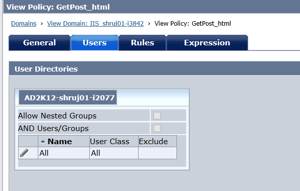

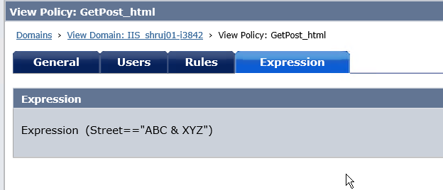

    Hi Shivam,
    Tested this today with 12.6.2. It works for me with the Policy expression.
    See the screenshot and the relevant logs below :
    Created a variable :
    Added Policy Expression Condition :
    Added all users :
    Now , I created two users in user directory  :
    1. shruj01 : street attribute = ABC & XYZ
    2. wonsa03 : street attribute = empty
    Tried login with shruj01 :
    [04/10/2018][07:24:39][2808][][SmJavaAPI.cpp:1238][JavaActiveExpression][][][][][][][][][][][][Active Expression evaluated for SmJavaAPI: JavaActiveExpression successfully invoked. Parameter and result follow:][1976][07:24:39.384][true][][][][][][][][][][][][][][][][][][][][][][][][][][][][][][][][][][][com.netegrity.scriptevaluation.scriptactiveexpression.ActiveScript (Street=="ABC & XYZ")][][][][][][][][][][]
    [04/10/2018][07:24:39][2808][s405/r8][Sm_Az_Message.cpp:828][CSm_Az_Message::FormatAttribute][shruj01@ca.com][CN=Ujwol Shrestha,CN=Users,DC=ad12,DC=lab][][][][][][<RVARS><Var name="Street" rtype="3"><![CDATA[ABC & XYZ]]></Var></RVARS>][][][IIS_shruj01-i3842][Send response attribute 147, data size is 71][1976][07:24:39.384][][][html][][][agent-shruj01-i3842][][][][][][][][][][][][][][4J9RpFZNClTDkqMEqn6zTfn2r8bS/Hb2wEitfi88pHVcmg/d6UAdKCdUtOGFThaNIF8hllWWbeSnAdu10GN4kiTO9fJNSmTVC1YpdA7XgoERHsbrGvR6jJo5FcxRKosZWvvB35CnAIGeyQ7B8ys2mj3FZUOPClZhuEkLRTY5xENQPWyZ6xPbpdSLnpdrc352vZybLmLQ5VIzboP23UB4NtcDD+H6acjIVQVjn05hhtu5Iud84YGq4ipx2lwyg2aoGptojjYN0koGVbvM1EqJ47dRFyU6A2LuCqZHlcxW8buYbEHQAAsiqhomP2m1XbzphmgDZTWC3u1Qkw+E26H/mGtqg1CbAPm7rhIN4amw/7T080HcSWlcgSrnoWUKbofIdABrUmZRQ2U/ocrfMwNlYkUS4UIskJeMs/wMR0teF45WJI/tZPmdD/b+30mptj5RLgA9VxW/1D5VOd4tcqBeyw==][][][][][][][][][][][][][AuthorizeEx][3c 52 56 41 52 53 3e 3c 56 61 72 20 6e 61 6d 65 3d 22 53 74 72 65 65 74 22 20 72 74 79 70 65 3d 22 33 22 3e 3c 21 5b 43 44 41 54 41 5b 41 42 43 20 26 20 58 59 5a 5d 5d 3e 3c 2f 56 61 72 3e 3c 2f 52 56 41 52 53 3e ][][][][][][][][][][][][]
    [04/10/2018][07:24:39][2808][s405/r8][Sm_Az_Message.cpp:598][CSm_Az_Message::SendReply][shruj01@ca.com][CN=Ujwol Shrestha,CN=Users,DC=ad12,DC=lab][][][][][][][][][IIS_shruj01-i3842][** Status: Authorized. ][1976][07:24:39.384][][][html][][][agent-shruj01-i3842][][][][][][][][][][][][][][4J9RpFZNClTDkqMEqn6zTfn2r8bS/Hb2wEitfi88pHVcmg/d6UAdKCdUtOGFThaNIF8hllWWbeSnAdu10GN4kiTO9fJNSmTVC1YpdA7XgoERHsbrGvR6jJo5FcxRKosZWvvB35CnAIGeyQ7B8ys2mj3FZUOPClZhuEkLRTY5xENQPWyZ6xPbpdSLnpdrc352vZybLmLQ5VIzboP23UB4NtcDD+H6acjIVQVjn05hhtu5Iud84YGq4ipx2lwyg2aoGptojjYN0koGVbvM1EqJ47dRFyU6A2LuCqZHlcxW8buYbEHQAAsiqhomP2m1XbzphmgDZTWC3u1Qkw+E26H/mGtqg1CbAPm7rhIN4amw/7T080HcSWlcgSrnoWUKbofIdABrUmZRQ2U/ocrfMwNlYkUS4UIskJeMs/wMR0teF45WJI/tZPmdD/b+30mptj5RLgA9VxW/1D5VOd4tcqBeyw==][][][][][][][][][][][][][][][][][][][][][][][][][][]
    Tried login with wonsa03 :
    [04/10/2018][07:28:45][2800][][SmJavaAPI.cpp:1238][JavaActiveExpression][][][][][][][][][][][][Active Expression evaluated for SmJavaAPI: JavaActiveExpression successfully invoked. Parameter and result follow:][1976][07:28:45.119][false][][][][][][][][][][][][][][][][][][][][][][][][][][][][][][][][][][][com.netegrity.scriptevaluation.scriptactiveexpression.ActiveScript (Street=="ABC & XYZ")][][][][][][][][][][]
    [04/10/2018][07:28:45][2800][s405/r12][Sm_Az_Message.cpp:828][CSm_Az_Message::FormatAttribute][wonsa03@ca.com][CN=Kelly Wong,CN=Users,DC=ad12,DC=lab][][][][][][<RVARS><Var name="Street" rtype="3"><![CDATA[]]></Var></RVARS>][][][IIS_shruj01-i3842][Send response attribute 147, data size is 62][1976][07:28:45.119][][][html][][][agent-shruj01-i3842][][][][][][][][][][][][][][jeUwVM7c+hwe22ClQnCpH9rV0wBKSGU3lesWej1g6EmTCbQa9I9ScvBRmGdo5zT2hhQ4SwfnftrG3YpzTN3+fkJLT32DBGL+ZJoYXRYzQzvmbNYucaJjFnp7LByNGB4O69o7U8DVtYXsqjJx6u1hRXd4AMF1uqvPTgLjUT+VdykswJ9Rs7xVYS28HNEorB6QgXfozTpc9cwZqib/gsGjzqD2jp7v0h9kDQwOEOBfrSEODr/MUqdriuGiJZ+WT7ZkQT95wQr5qq4Xk2CBenHhFRtcrIRM0r6YIdn8UYmyhvy0k6+q376ma3gsICmmcihVG/***9E91qpLuntrwdhTk53agznA3DD/weaIFQwmZhUBtPIQU7DaIsSWiemjmrzdrpS4JCFTjtbqiwzQnxYXKOax01+UIejH1NHqVe9CoRVpuvJErNwbdPL7Lx136WMRda8hZnYYnoKT+vIpK7zAqg==][][][][][][][][][][][][][AuthorizeEx][3c 52 56 41 52 53 3e 3c 56 61 72 20 6e 61 6d 65 3d 22 53 74 72 65 65 74 22 20 72 74 79 70 65 3d 22 33 22 3e 3c 21 5b 43 44 41 54 41 5b 5d 5d 3e 3c 2f 56 61 72 3e 3c 2f 52 56 41 52 53 3e ][][][][][][][][][][][][]
    [04/10/2018][07:28:45][2800][s405/r12][Sm_Az_Message.cpp:598][CSm_Az_Message::SendReply][wonsa03@ca.com][CN=Kelly Wong,CN=Users,DC=ad12,DC=lab][][][][][][][][][IIS_shruj01-i3842][** Status: Not Authorized. ][1976][07:28:45.119][][][html][][][agent-shruj01-i3842][][][][][][][][][][][][][][jeUwVM7c+hwe22ClQnCpH9rV0wBKSGU3lesWej1g6EmTCbQa9I9ScvBRmGdo5zT2hhQ4SwfnftrG3YpzTN3+fkJLT32DBGL+ZJoYXRYzQzvmbNYucaJjFnp7LByNGB4O69o7U8DVtYXsqjJx6u1hRXd4AMF1uqvPTgLjUT+VdykswJ9Rs7xVYS28HNEorB6QgXfozTpc9cwZqib/gsGjzqD2jp7v0h9kDQwOEOBfrSEODr/MUqdriuGiJZ+WT7ZkQT95wQr5qq4Xk2CBenHhFRtcrIRM0r6YIdn8UYmyhvy0k6+q376ma3gsICmmcihVG/***9E91qpLuntrwdhTk53agznA3DD/weaIFQwmZhUBtPIQU7DaIsSWiemjmrzdrpS4JCFTjtbqiwzQnxYXKOax01+UIejH1NHqVe9CoRVpuvJErNwbdPL7Lx136WMRda8hZnYYnoKT+vIpK7zAqg==][][][][][][][][][][][][][][][][][][][][][][][][][][]
