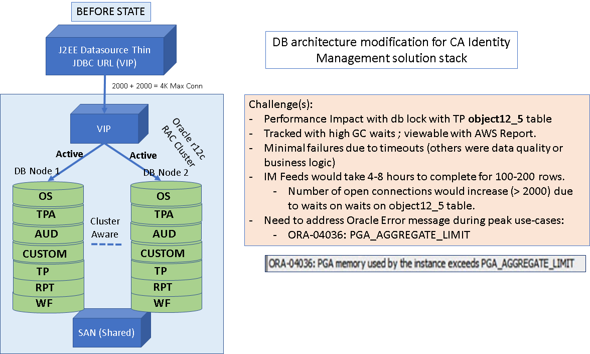

    History:    We started with this below process.  While this configuration below worked; it would not scale to the larger numbers we needed.   (To see AWR report for this initial deployment - scroll to bottom)

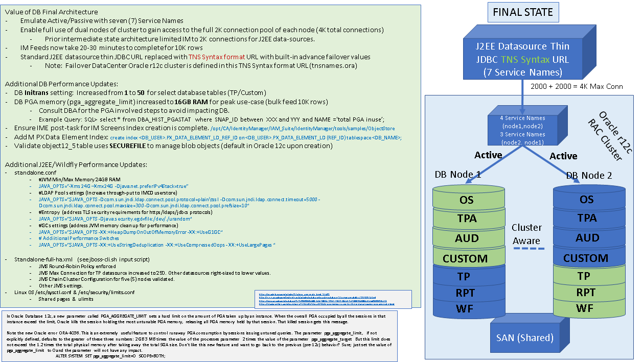

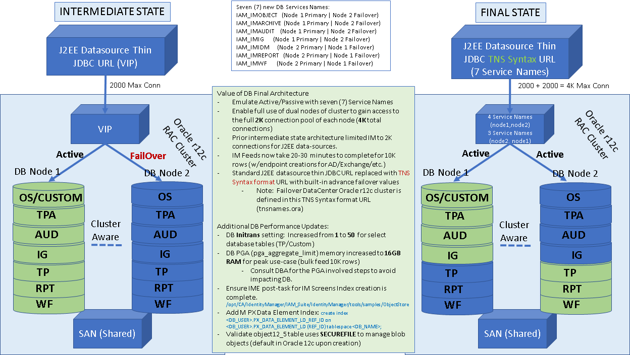

    Our intermediate state, and final state:
    List of changes made for the database and J2EE tier.
    Dual cluster view in two (2) data centers:
    New DB Service Names to replace the single VIP address:

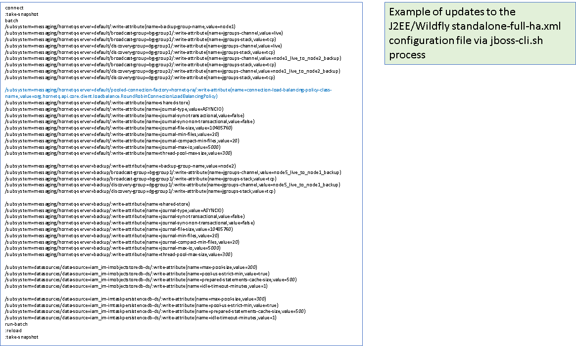

    Example of jboss-cli.sh script used to update the J2EE/Wildfly standalone-full-ha.xml configuration file (on the fly).
    Example of using the jboss-cli.sh process to view the stats of the DB connection pool.
    - This process assisted with us deciding to increase the default connection pool for the TP data source to a larger number, and then lower the max value for the other data source values.   This process also confirmed that the five (5) node J2EE cluster was working correctly and sharing the load among all members.   We did discover that we needed to explicitly declare the JMS pool to use round-robin policy, otherwise one node was being overwhelmed.
    /subsystem=messaging/hornetq-server=default/pooled-connection-factory=hornetq-ra/:write-attribute(name=connection-load-balancing-policy-class-name,value=org.hornetq.api.core.client.loadbalance.RoundRobinConnecti"margin-top: 0pt; margin-bottom: 0pt; margin-left: 0in;">

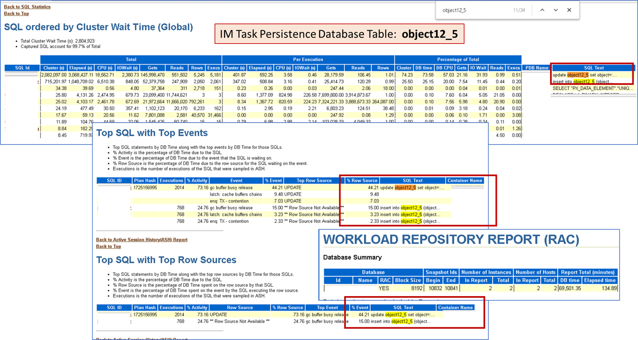

    PS.  Example of the AWR report that help identified the I/O issue with IM Task Persistence Database's object12_5 table due to RAC configuration; and the need to add indexes to the PX Data Element table.
    Example to run a AWR report from Oracle GUI:
    select dba_hist_snapshot.* from dba_hist_snapshot order by 5 desc;
    select output from table (dbms_workload_repository.awr_global_report_html((select dbid from v$database),'1,2’,<Add_Beginning_Time_Index_Here>,<Add_Next_Time_Index_Here>));
    Example of AWR report (summary sections):
