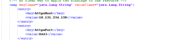

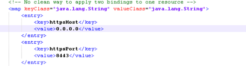

    Ok, the file you need to modify is :
    <Admin UI Install Directory>\server\default\conf\bindingservice.beans\META-INF\bindings-jboss-beans.xml
    Look for httpHost or httpsHost property depending on which you want to configure.
    Here is the result from my test:
    Case 1 : httpsHost =10.131.234.158
    Case 2 : httpsHost = 0.0.0.0
    Hope this works for you as well.
