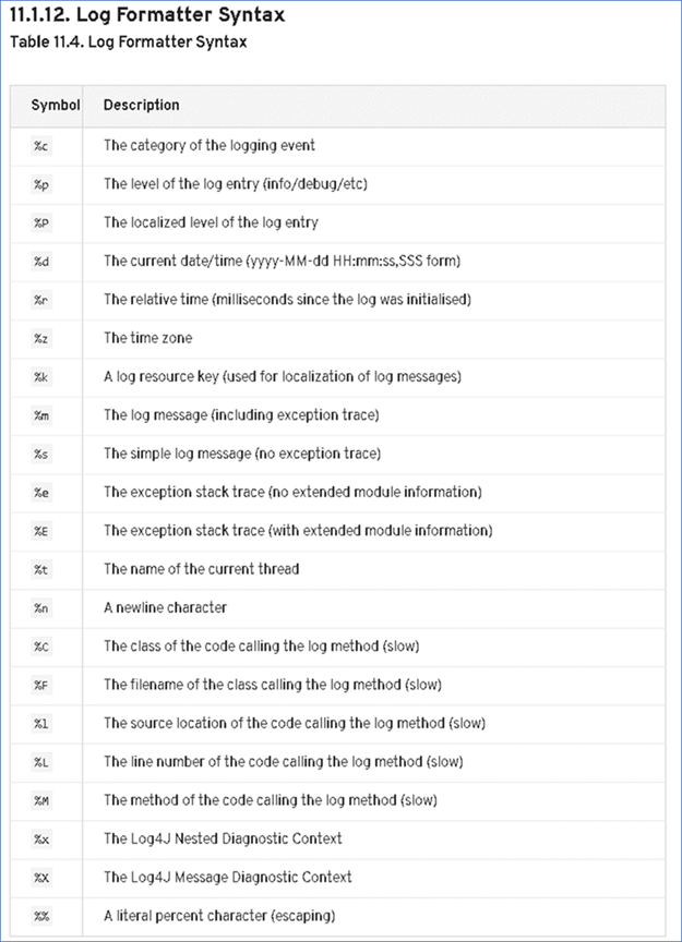

Edit: 9/10/2018 Two (2) items:
1) Update logger/appender's formatter pattern to have IP address/NodeName within the log file, so when consolidation is utilized, the resource will be able to identify where the cluster logs originated from.
2) Added space for the %s%E pattern & %l to assist with RCA .

Log4J Formatter Syntax Reference:
https://access.redhat.com/documentation/en-us/jboss_enterprise_application_platform/6/html/administration_and_configuration_guide/chap-the_logging_subsystem#Log_Formatter_Syntax1
