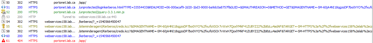

  • 12.  Re: Kerberos fallback to form
    Posted Oct 25, 2018 05:42 PM
    Here is the problem:
    it redirects to the context protected by default Kerberos auth scheme but it did not redirects to that auth scheme of creds.kcc and just fallsback to form based.
    When i try to access that context protected with kerberos directly it works fine and redirects to creds.kcc. So in this case i am always getting redirected to form based login.
    Thanks,
    Kanishak
  • 13.  Re: Kerberos fallback to form
    Posted Oct 25, 2018 10:40 PM
    Issue might be coming as context protected by Kerberos auth scheme is xmlhttp type and does not redirect to creds.kcc? Have you tested it?
