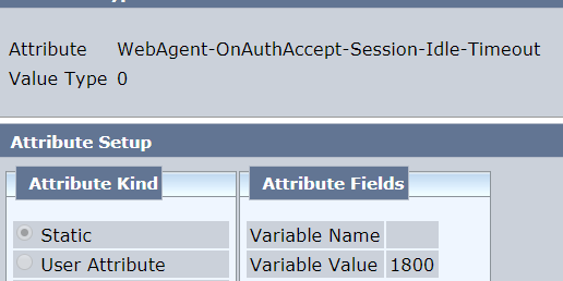

    It is possible when you use EnforceRealmTimeouts .
    To override the Idle Timeout value,
    Create Authentication event RULE with action OnAuthAccept
    Create response of type WebAgent-OnAuthAccept-Session-Idle-Timeout, and set to the desired value in seconds.
    In the Policy add the Authentication event RULE then set the set the new responses to that rule
