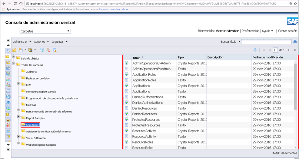

    2) Yes, the Siteminder related reports are available on the report server:

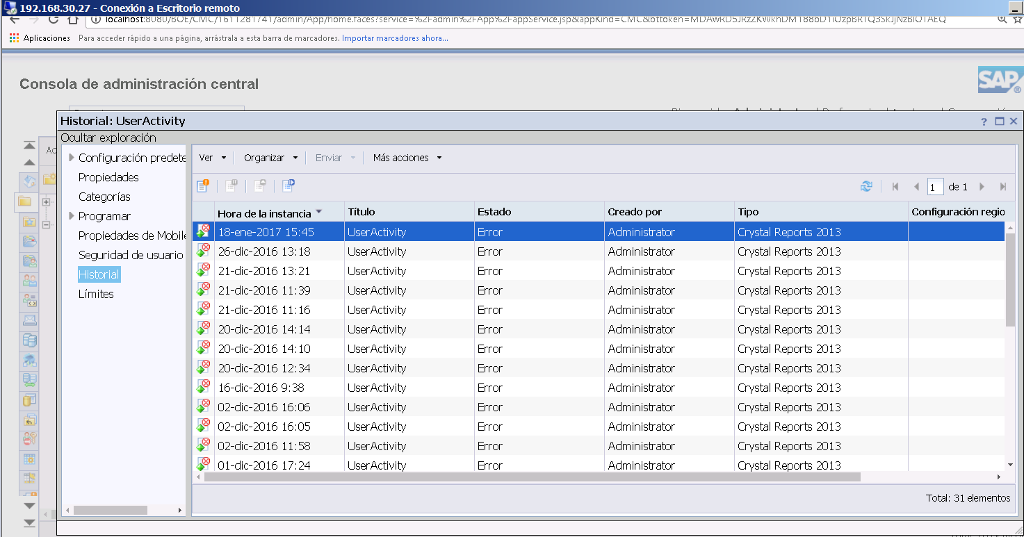

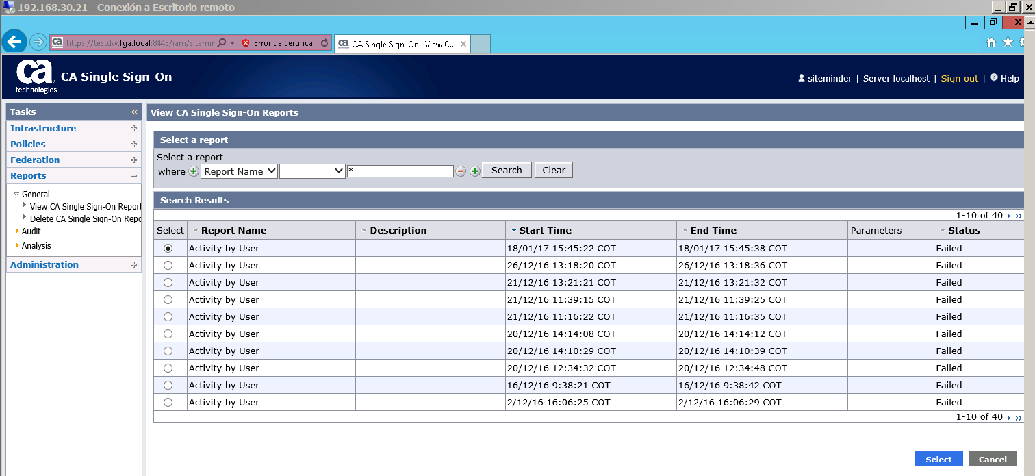

    4) The communication between the Policy Server and the Report Server appears to be established. In fact, records with generated report data with failed status can be seen in both the Admin UI and the InfoView app:

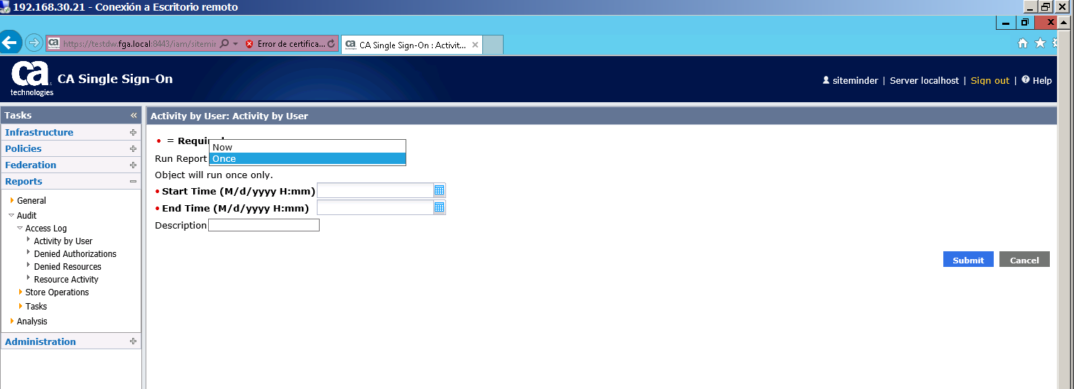

    Now Ujwol, I have been reviewing the generation process reports today and I noticed something curious. Usually when requesting reports with the CA tools, the first window that is shown is one where parameters are specified. In my case, this window does not appear. Instead, the first window I see is one where you specify whether the report is going to be generated immediately or in the future:

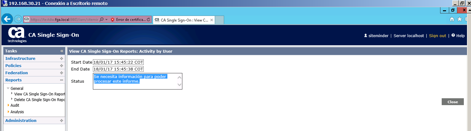

    That is, I have no possibility to indicate the range of dates for which the report will be generated. Additionally when I see the detail of the reports that I have tried to generate the status detail indicates: "You need information to be able to process this report."
    This would seem to indicate that such a parameter window is required, will you or any member of the community know if that screen was removed from version 12.52 SP2? Or is this some error in this version?
