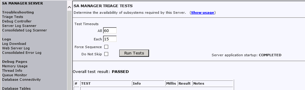

    The most important fact is that after OS patches installations the servers will have to be rebooted. As a best practice we suggest to shutdown the whole SOI environment before that reboot. The SOI Services can be set to startup manual in the Service Controller and after the successful reboot of the servers we can begin the startup of SOI. Start the CA SAM Application Server on the SOI Manager in the Service Controller. To verify that the CA SAM Application Server is up and running we can open the SOI Manager Debug page http://<soimanager>:7090/sam/debug - Triage Test and wait until the Server application startup shows as COMPLETED.

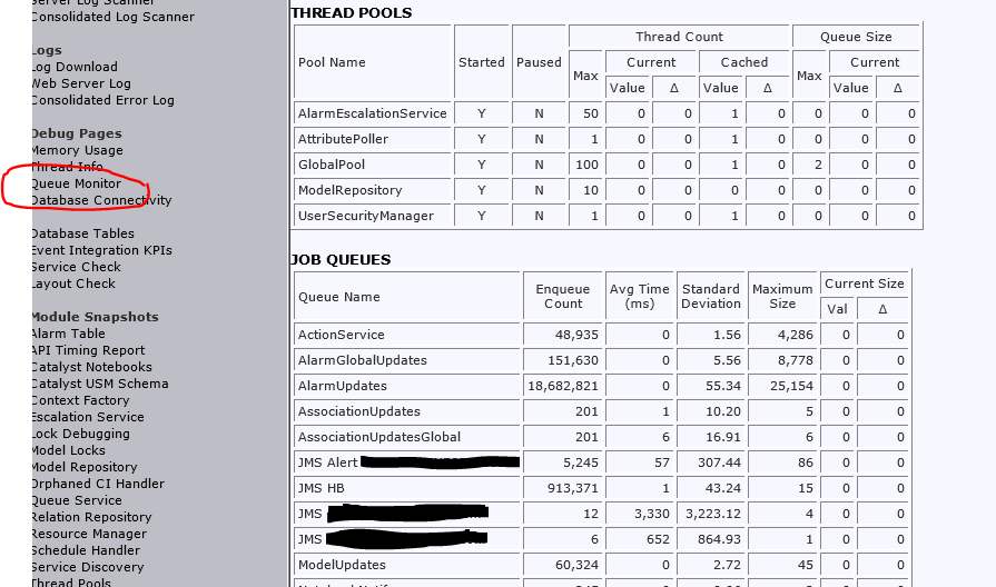

    Now we would take a look at the Queue Monitor on the SOI Manager debug page to verify the jobs in the job queues are processed. You will see in the Queue Size Value and Delta columns red figures indicating the number jobs that are added to the queues and blue figures indicating the number of jobs processed from the queues
