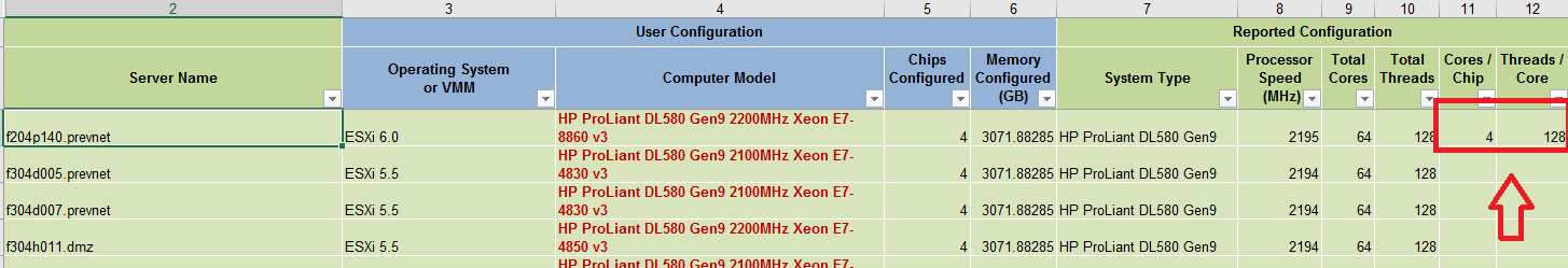

    Hi,
    Is there any way to get the records highlighted in the spreadsheet below
    I believe these records are not validating the f204p140.prevnet host because of this information, they are there because I did the pulldata of the csv file GenericConfiguration.csv and it was only for this host I did with this file.

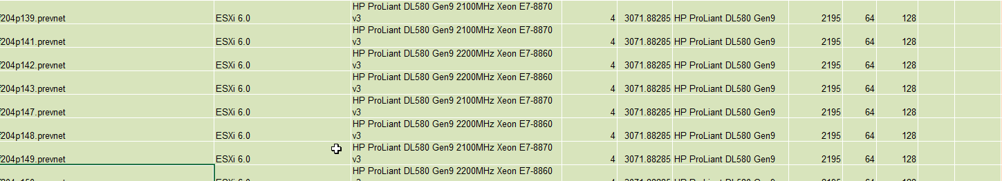

    The other hosts with same family are Ok as I did with the GenericCMLConfiguration.csv file, take a look below:
    How do I fix this f204p140.prevnet , ie get information from the Reported Configuration?
    Thank you!

    Hi David,
    I was making a mistake in performing the calculation in csv file
    Total Cores = Configured Chips * Cores / Chip
    Total Threads = Configured Chips * Cores / Chip * Threads / Core
    After I made the correct calculation to hit the recommendations both orange area with Reported Configuration, it worked perfectly and the spreadsheet was corrected.
