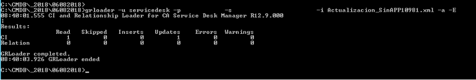

    and on the error file I see that the location is not found 'BODEGA CENTRAL 1'. But if I use the same archive and then use the grloader command, this upload without error or Warning.

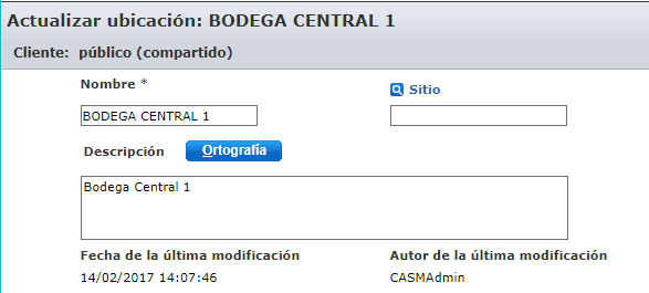

    This is the name of location.

    The operator is Register via Grloader and this operator need a input file, on my case the archive is a xml, but when the operator read the file, update the other fields less the location.
    now I copied the xml input and try to charge with the command on the SDM Server, the location update without problem.
