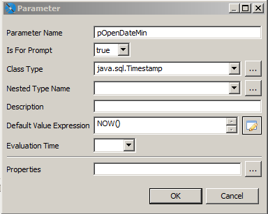

    Here is one way to add selection by date to a report using the SDM connector, using parameters.
    1. In Jaspersoft Studio, open the report and open the Dataset and Query Editor.  Go to the 'Parameters' tab:
    You can hide the built-in parameters by clicking the icon above the parameters list (highlighted above).
    2. Click the 'Add' button and add a parameter with the following properties:
    This is the parameter that will prompt for the earliest open date.  Because it is defined as 'java.sql.Timestamp' it will launch a calendar prompt.
    Enter this as the 'Default Value Expression':
    NOW()

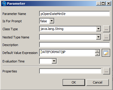

    3. Add a second parameter with the properties shown below:
    DATEFORMAT($P{pOpenDateMin},"yyyy-MM-dd HH:mm:ss")
    This parameter does not prompt. Its purpose is to convert the value that was entered in the Date parameter into a String.

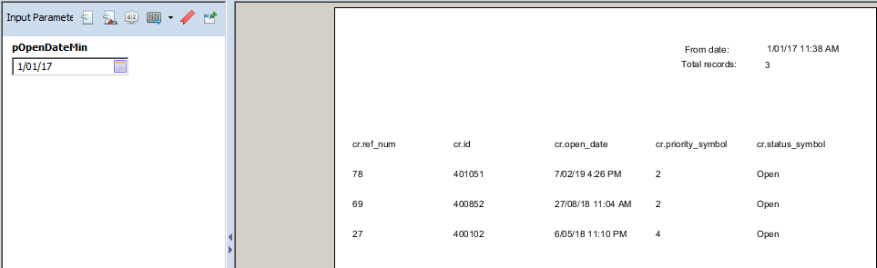

    5. Preview the report.
    The date parameter will be prompted for and the report will show only records opened after the selected date.  I have added the parameter value to the Title band.
    Hope that gets you going.

    Hi Bakhtawar,
    please attach your 'jrxml' files to the thread - I'll take a look.  Could it be that you have added 'pOpenDateMin' to the sub-report, rather than 'pOpenDateMinStr'?
    Regards,
    James
  • 31.  Re: Jasper reports Data loading issue
    Posted May 13, 2019 03:55 AM
    Hi James,
    Hope you are doing good.
    Sorry for the late reply actually i was quite busy so unable to reply.
    You were asking about jrxml file but i didn't able to send it to you because when i copy it from folder to send it to you it won't allow me to copy files. So how can i send it to you?
