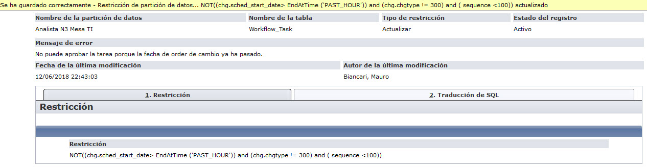

    1) By data partition for the name of the table: Workflow_Task and type of restriction: Update
    was configured as follows:
    NOT((chg.sched_start_date> EndAtTime ('PAST_HOUR')) and (chg.chgtype! = 300) and
    ( sequence <100))
    In this case I am indicating that if the window start date or implementation date is
    greater than the current time and the change is different from emergency and that the
    sequence is less than 100 (1st execution task) and all that denied, show me the message
    that the approval of the respective tasks is not allowed because the window date has
    already passed. This works for the CO that are emergency and no matter if the window is
    expired or not and if the sequence is less than or greater than 100. The problem occurs
    when you want to work with CO approvals that are NOT EMERGENCY type and trying to
    implement the restriction with the indicated conditions but the result is not successful.
