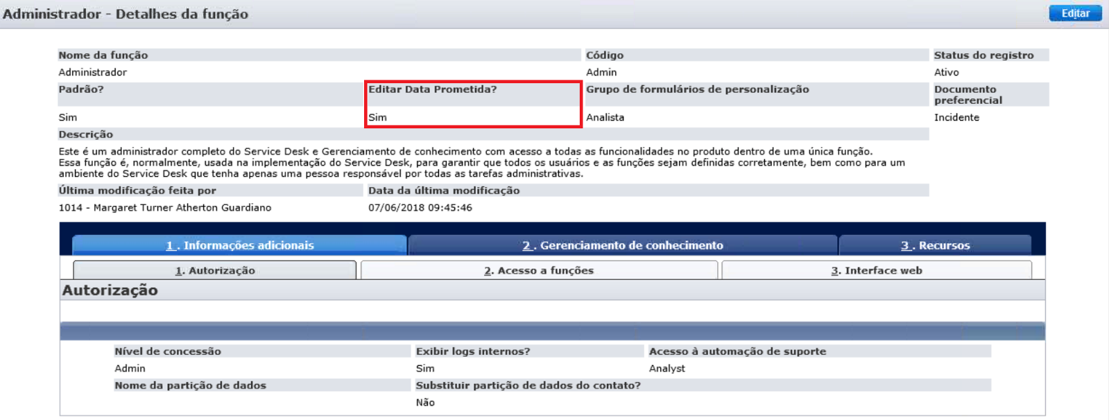

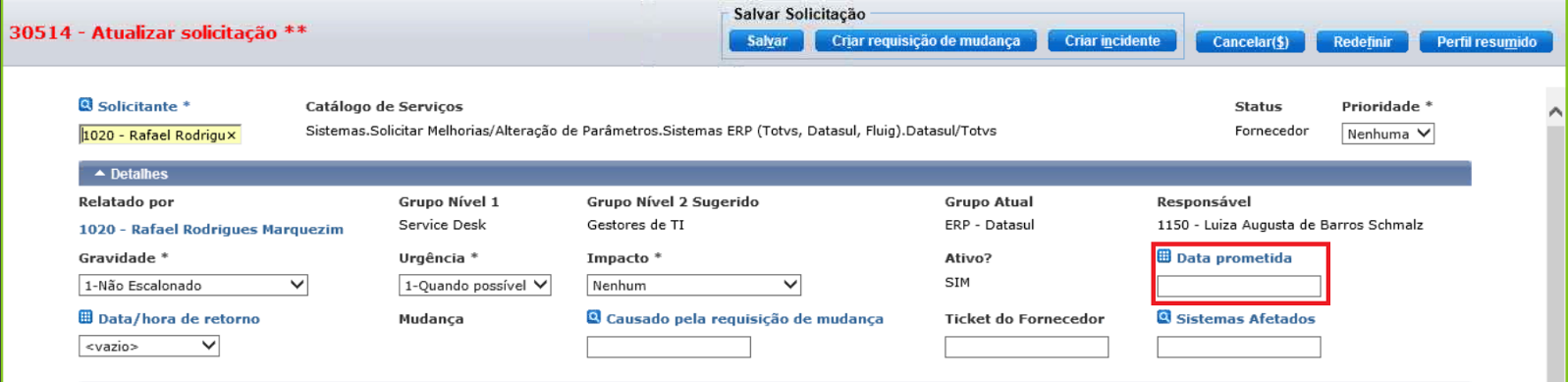

    I have a little problem and I hope you can help me. There is a field (z_data_prometida) on the detail_cr.htmpl, and I need this field to be editable when a flag in the user's role is active.
    I'll explain my problem in more detail.
    There is a field (z_edita_data_prometida) in the user's role (detail_role.htmpl), which can be marked as "YES" or "NO".
    If the user who is logged in is using this function, and the function is marked "YES", the field (z_data_prometida) of the screen (detail_cr.htmpl) must be editable.

    I put the following code in <head>.
    <head>
    <script>
    var editarDataPrometida;
    <pdm_list prefix=r factory=role where="id=$SESSION.ROLE_ID">
              editarDataPrometida = "$r.z_edita_data_prometida";
    </pdm_list>
    </script>
    </head>
    And the PDM_IF code ...
    <PDM_IF editarDataPrometida != "0">
    <PDM_MACRO name=dtlDate hdr="Data prometida" attr="z_data_prometida">
    <PDM_ELSE>
    <PDM_MACRO name=dtlReadonly hdr="Data prometida" attr="z_data_prometida">
    </PDM_IF>
    Thanks!
