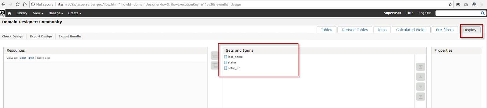

    I then created a new domain in jasper using this view

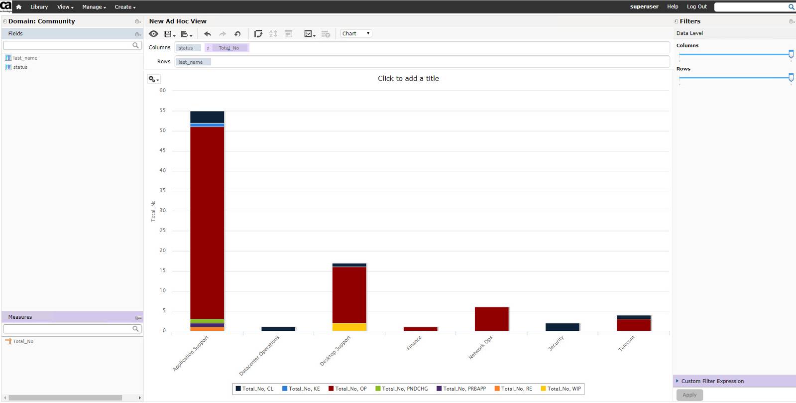

    in display tab specify fields to be included in your future adhoc view and adhoc report:
    click OK and Submit your domain.
    Now create an adhoc view using this domain:
    here is an example of your query:
  • 18.  Re: Hello Everyone, i keep getting this error when i try to create a report using the adhoc view in the jasper reporting tool

    I have seen the steps, do you mean I have to create a view because I see you modified the script?
    Thanks
  • 19.  Re: Hello Everyone, i keep getting this error when i try to create a report using the adhoc view in the jasper reporting tool
    Best Answer
    Broadcom Employee
    Posted Aug 29, 2018 11:39 AM
    Hi
    in fact, it sounds that jasper and domain in particular doesn't "like" binary fields like uuid. this is why you can not see all the columns in Jasper Domain.
    Creating View is one answer.

    Yes creating the view solved the error message. Thank you for the assistance.
    Thanks
