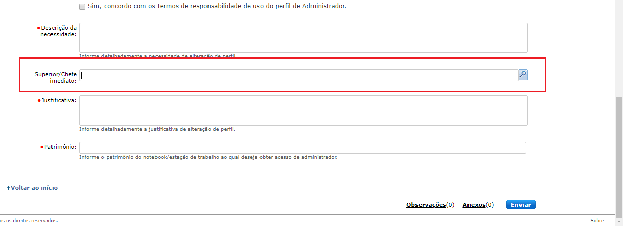

    I'm having some difficulties creating a lookup field to bring users from SDM in order to notify this contact contained in this field.
    I created the data object for use in ca_fdDoFieldLookup according to the query below:
    Database: mdb
    Table: ca_contact
    Fields: value, label
    Query:
    select contact_uuid as value, last_name as label from mdb.dbo.ca_contact where userid is not null
    In the form i created a lookup field with the following attributes:
    _id: ca_sdm_attr_z_SuperiorImediato (this custom attribute is a SREL from the cnt factory)
    onLookup: ca_fdDoFieldLookup ('last_name', 'caContactPlugin')
    When I select the field to view the values it does not give me a search option or even allows users to search with the value entered in the lookup field.
    Is there anything I should do besides creating this query and making the field available?
    Bellow the form and popup lookup field:
    Many thanks for your help!

    Hi Diego,
    You need to pass the _id of the lookup field as the first argument similar to the following:
    ca_fdDoFieldLookup('ca_sdm_attr_z_SuperiorImediato', 'caContactPlugin');
    Also, note that the form field(s) that you want populated with the results of this lookup need to have the same _id as the column/alias in your data object. As an example, if you want the lookup field populated with the last_name from the data object you would either need to specify the lookup field _id as 'label' or update your query to alias last_name as 'ca_sdm_attr_z_SuperiorImediato'.
    Thanks,
    Jason
