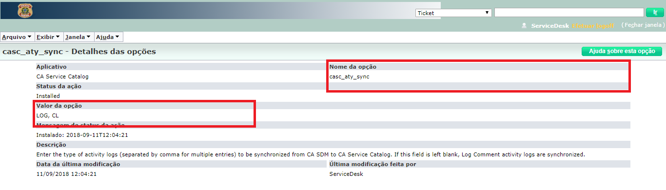

    Hi johsc03!
    I could not understand the reason, but when doing new tests today with tickets in CL and CNCL, the status are not having being replicated to the Catalog!
    Yesterday when I did tests, the tickets had their status synchronized correctly, however to look today and perform new tests, the synchrony seems to be no longer working, even with the option casc_aty_sync installed, as shown:.
    Option manager:

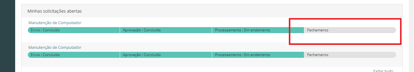

    Is there anything I can do to find out where the error is?
    The two tickets in CL and CNCL status:

    Hi Diego,
    You would also need to add CNCL to casc_aty_sync.

    Broadcom Employee
    Posted Sep 11, 2018 11:35 AM
    Hi Diego,
    The image provided from Catalog is to configure the behavior when closing a ticket in Catalog which has a SDM ticket associated (Catalog to SDM). Based on your feedback you want to close the ticket in Catalog from the SDM ticket (SDM to Catalog), so you close the ticket in SDM and then the ticket in Catalog is set to completed. If so, this is enable by default in the itsm.maj file and it will only work when using the CL status in SDM. If this is the case, then there might be an error in SDM\logs\jstd.log and in view.log.
    Please check those logs in the timeframe when the ticket is closed in SDM.
