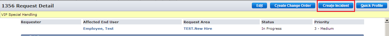

The supported process here is for users of Self-service to create Requests only and then an analyst to create a new Incident from a Request using the original as the basis when required. This will copy selected fields into the new ticket and create a relationship between them.
You would then complete the Incident and then close the initial Request. The allows for separate processes for Requests and Incidents at the cost of possible confusing the customer with two tickets.
